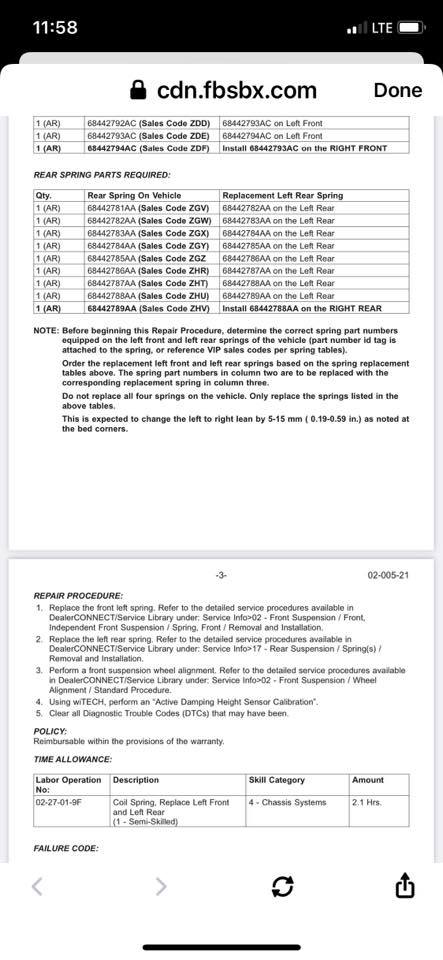

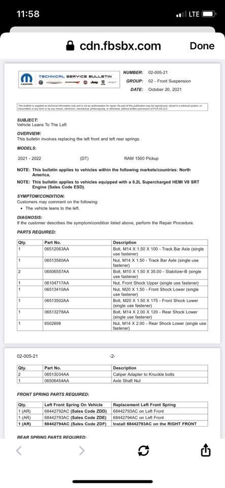

no, from what I saw there is an over all lean to the drivers side and on the 2022 there is a new part number for the drivers side springs to fix the lean. It has also been prevalent on the regular rams over the years and is more noticeable when the gas tank is full

I looked at mine again and so far I don’t have the Squat. The rear is very simple to replace the spring. The front being a coil over is a little harder but still basic stuff. I did see where they replace a lot of hardware because they label it as one time use.
