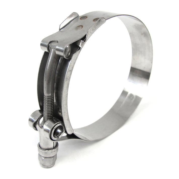

Might want to pay extra attention to the clamps on the throttle body. Saw a few guys have their couplers pop off. I am swapping the worm clamps to T-bolts when I put the Incognito on but haven’t had any issues myself.
do you have a link for the T-bolts that you are switching to?
I haven’t tried them yet but they should be right. I matched the sizes based off what S&B lists in the instruction manual. SAE #64 at the TB and #72 at the tube.
2,006
thanks. So do these just have more clamping power?
Yeah, you can put way more torque on them and they have a wider area. The worm clamps will just strip out if you tighten them too much.
I’m not saying it is because I haven’t tied to put it on the truck, but does it look like this is a little small?
Yeah, I just took a look. Too small. Guessing SAE 72 in a T-Bolt isn’t the same as a worm clamp or there’s no equivalent? No clue, but my bad on that for assuming.
2,006
No worries, it was worth a shot. I got it through amazon so i should be able to return.
and just so there is no mix up, that picture is of the smaller size for the connection to the throttle body.
Yeah, even the bigger of the two I ordered was too small for the smaller location. I compared it against the stock tube hanging in the shed. I’ll do some homework and see if I can find something that works.
