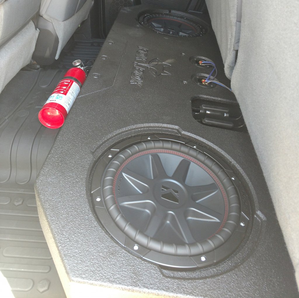

My truck system is pretty stout though. 3 kicker amps, Kicker DSP, AudioControl LC6i and all the door and dash speakers are amp'd. No components this time though, went straight 6x9 three ways in the doors and 3.5 two ways in the dash. Honestly wasn't expecting much with this setup but, for a completely hidden install... It rips! Of course, fully sound deadened interior, AGM battery and Big 3 upgrade. Only pic I have is the CVRs and my fox box.
Mine is just loud and does okay, OP's is way more of a high fidelity setup. Probably sounds amazing!! Wish mine had a bit more adjustability.
