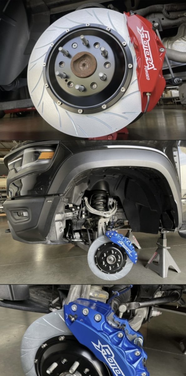

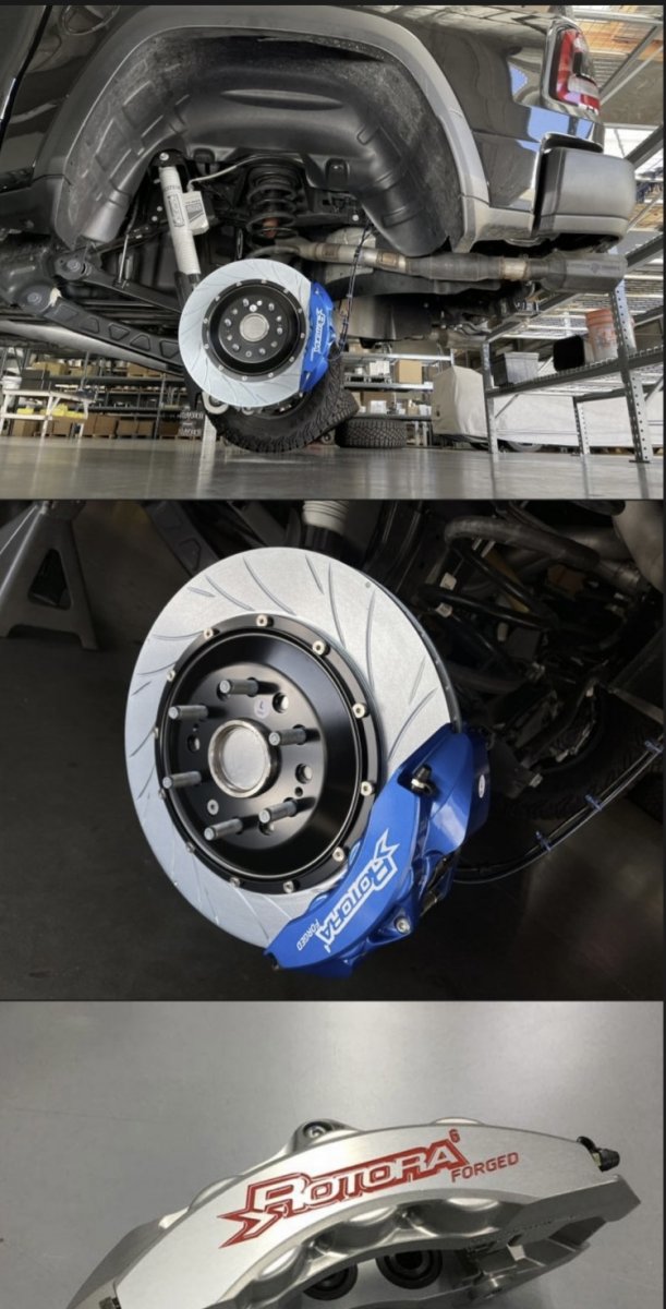

Rotora is making a 6 piston front and 4 piston rear kit that clears the stock 18s. That’s the direction I’m leaning, however it’s just not in the budget right now. I believe they start around 2k per end.

EBC is also working on pads for our trucks which may be a good cheap option.

wow that is impressive that they are making 6 piston calipers to fit 18" wheels.

Yeah, that’s what I said. Would like to see some real world feedback once people install them.
They also offer an even bigger kit that requires 20s.
