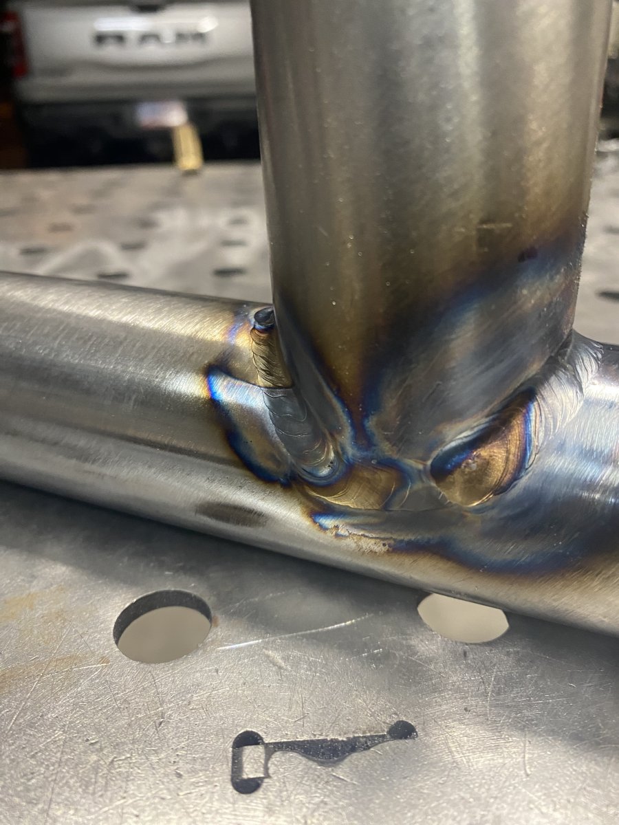

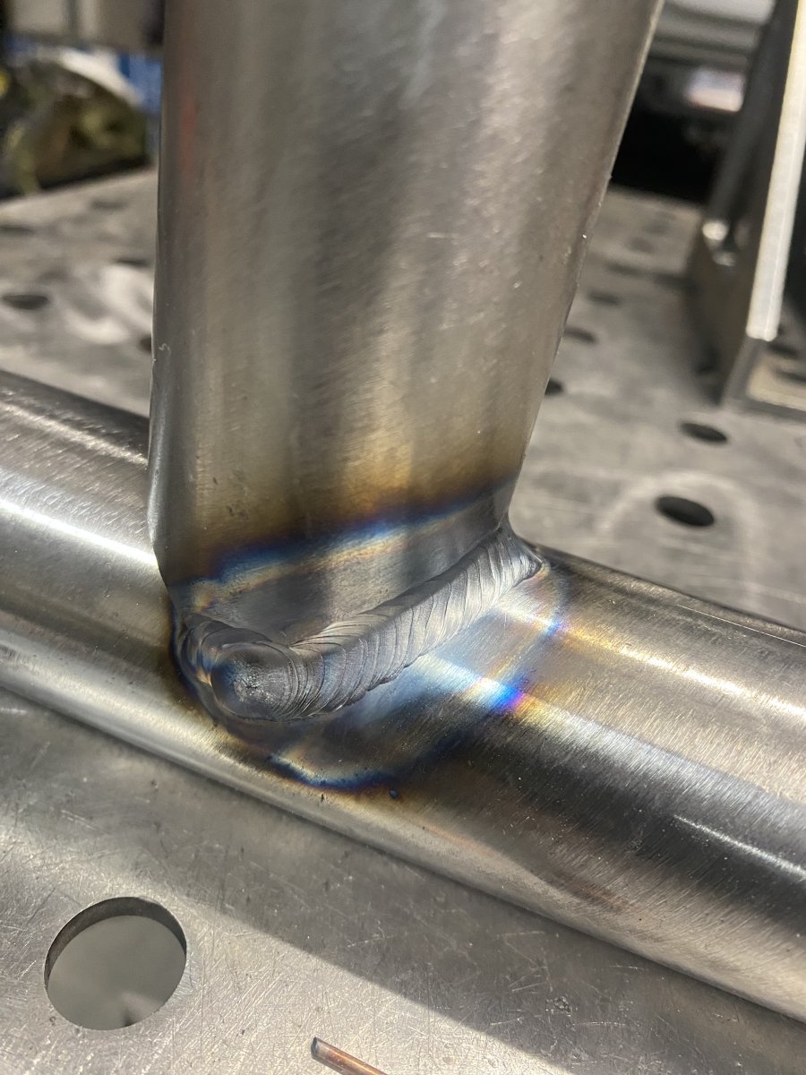

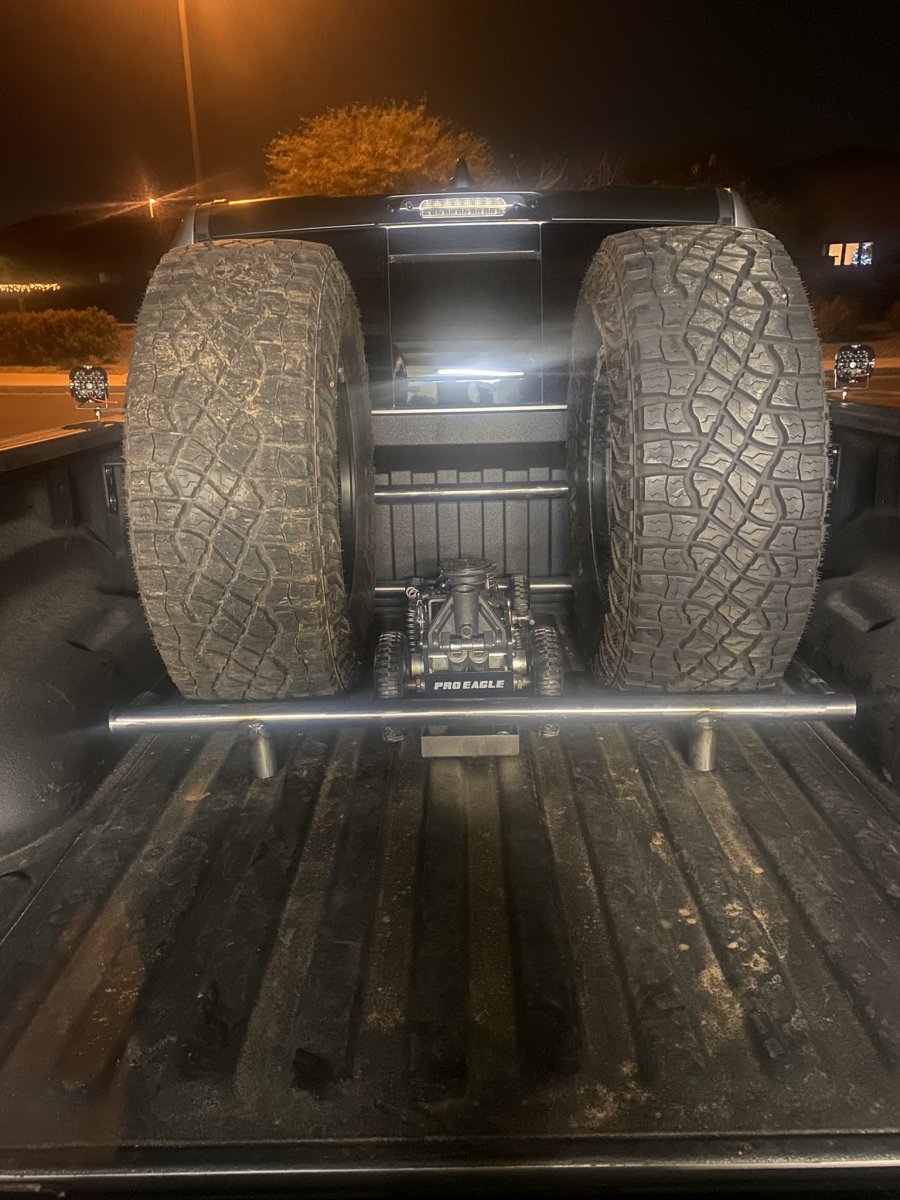

Nice welding there brother. 👍👍
Thank you. I’ll do a second pass on the welds as well I like to 2 pass most of my tube welds. First pass is straight current getting good filler material and making a strong joint. Second is pulsed to add more filler and give a nice stack of dimes look.

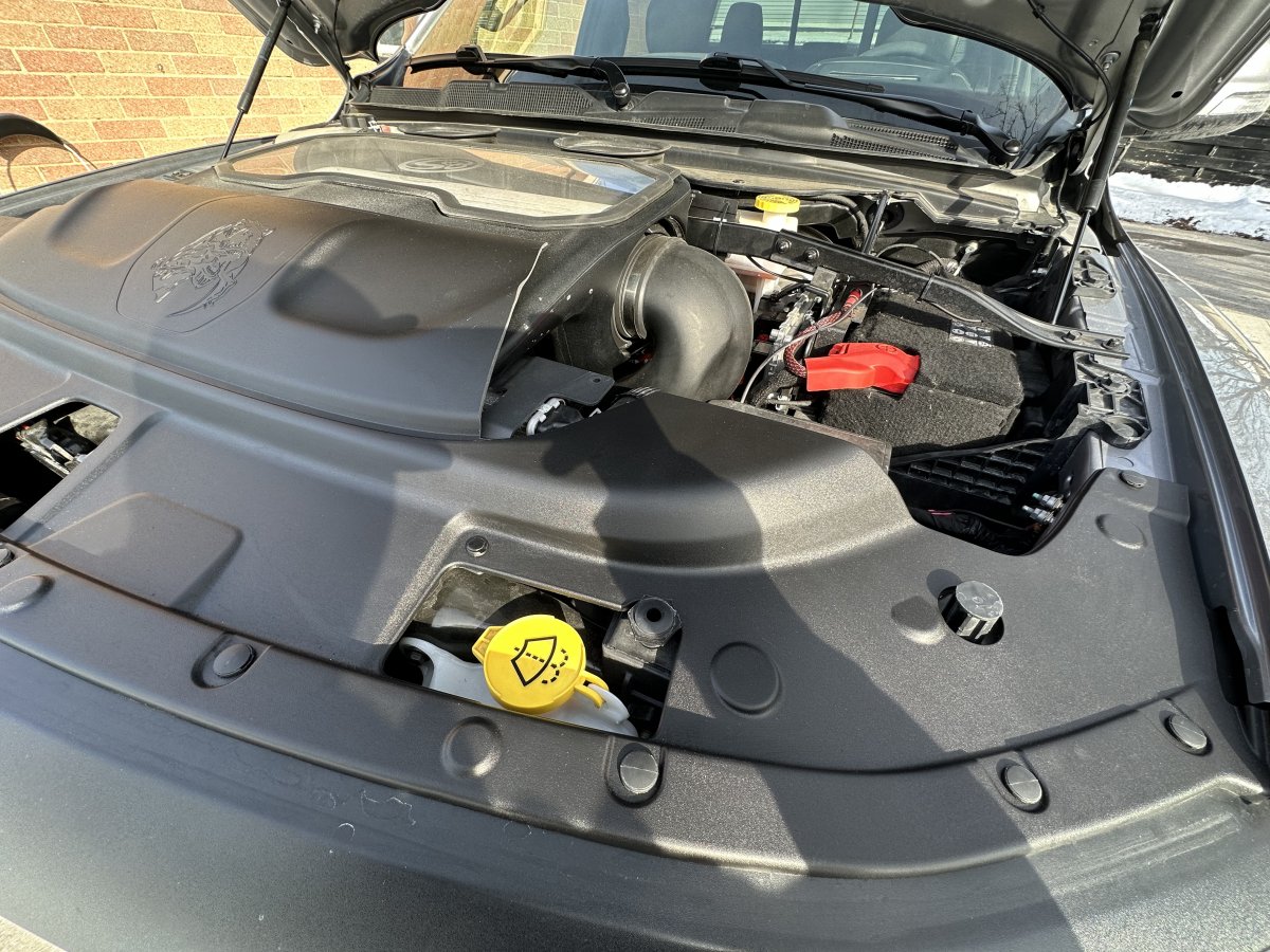

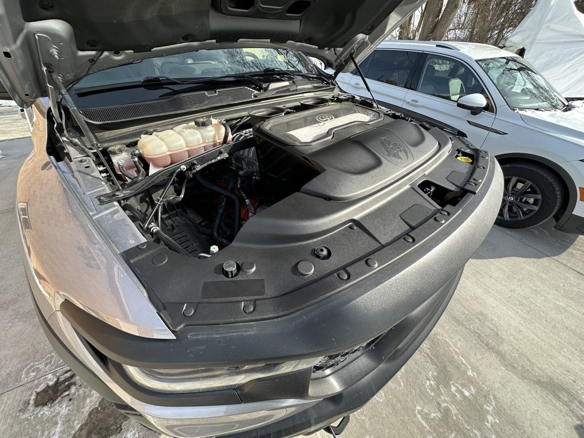

I ordered an extra radiator close-out plastic so I could hack it up to work with the S&B. Came pre-hacked unfortunately. Waited two months for the thing and it had a crack. Way too big to send back so I just cut the cracked portion off when I was trimming everything else. Maybe someday I’ll get another but for now it’s fine. Just didn’t wanna do this to the original. Yes, I also ordered the A/C sticker for $6, just hasn’t come yet.

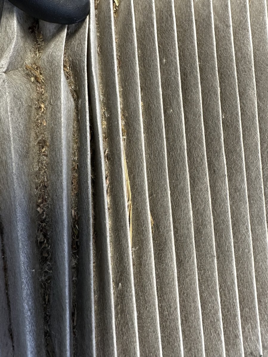

Also changed the cabin air filter. Yuck.

Very nice. I’m shocked how dirty the cabin air filter was already. Is that still behind the glove box? Got a part # on it?

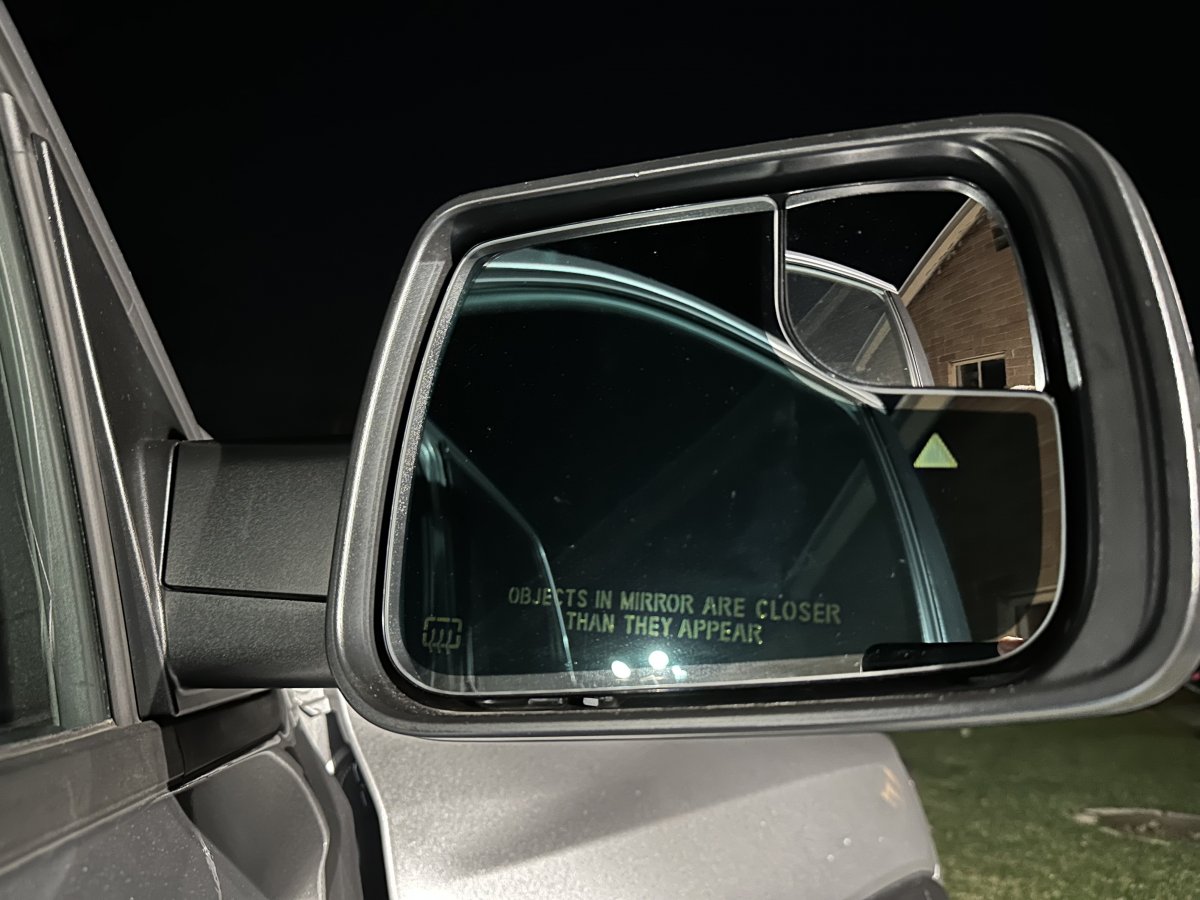

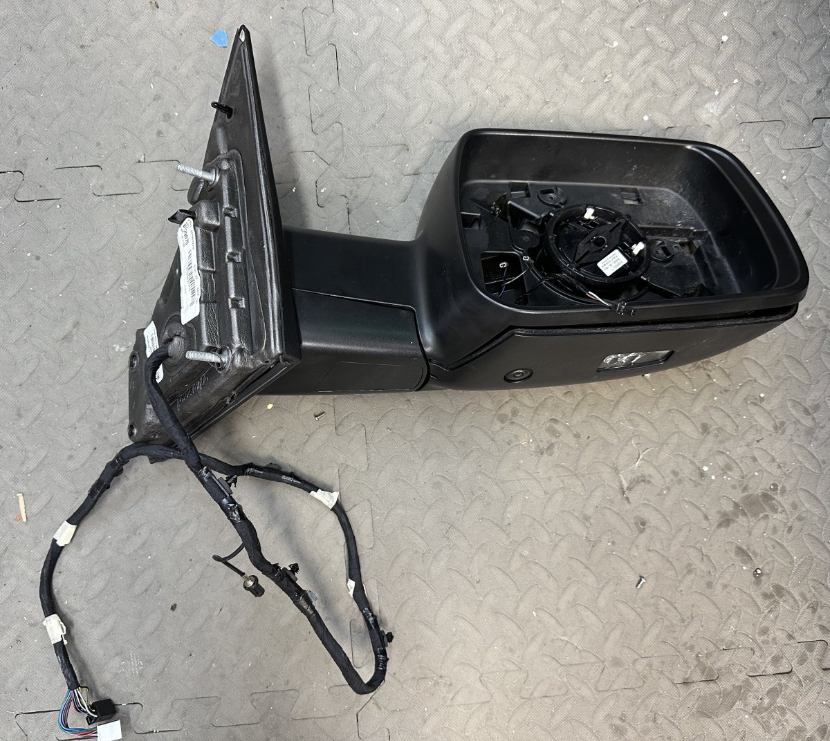

Added passenger side auto-dim functions because screw you Ram. Holding out on us poor TRX owners even though the Limited gets it.
533
very nice.....what did that involve?
I bought a complete donor mirror assembly from a Limited for $120. Extracted the two autodimming wires, plug and glass off of it and chucked the rest. It can be done with new parts too but it would cost around double. Not a difficult thing to do though.
