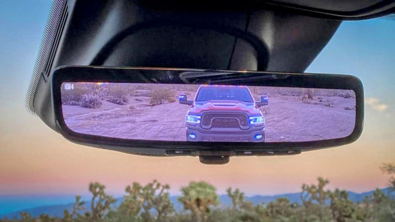

camera turned off as a regular Mirror (note that my back-flip was folded up against the rear window so that is why its all black)
Camera turned on:
Also we measured and the bottom of the camera view is right about 6-3/8” above the tailgate. It’s not a big issue because i can still see cars but it’s harder to judge how close they are to you since you can’t see the tailgate.

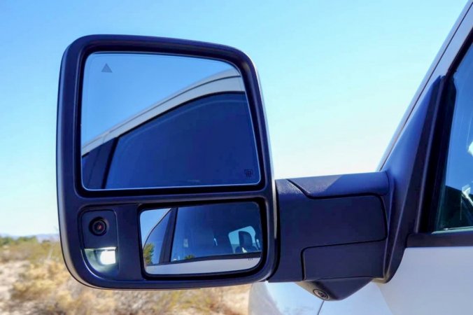

A bit more research, the HD tow mirrors have backwards facing cameras as you can see in the picture below, we dont have such an option on our TRX as far as I am aware.
Also the digital rear view mirror that has this function can be differentiated from the typical TRX DRVM by having a 4th button to the left of the center activation switch/lever.
Still trying to find the correct PN for this mirror.
