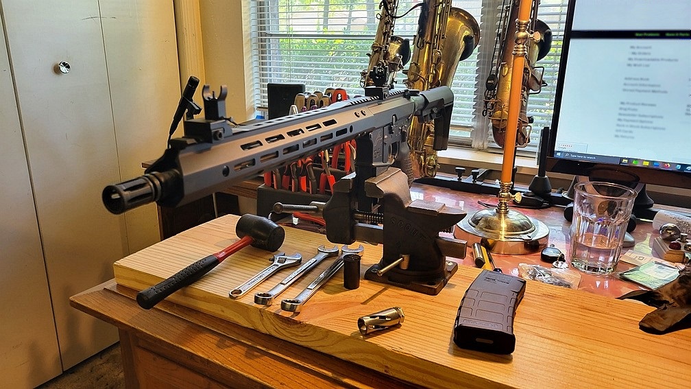

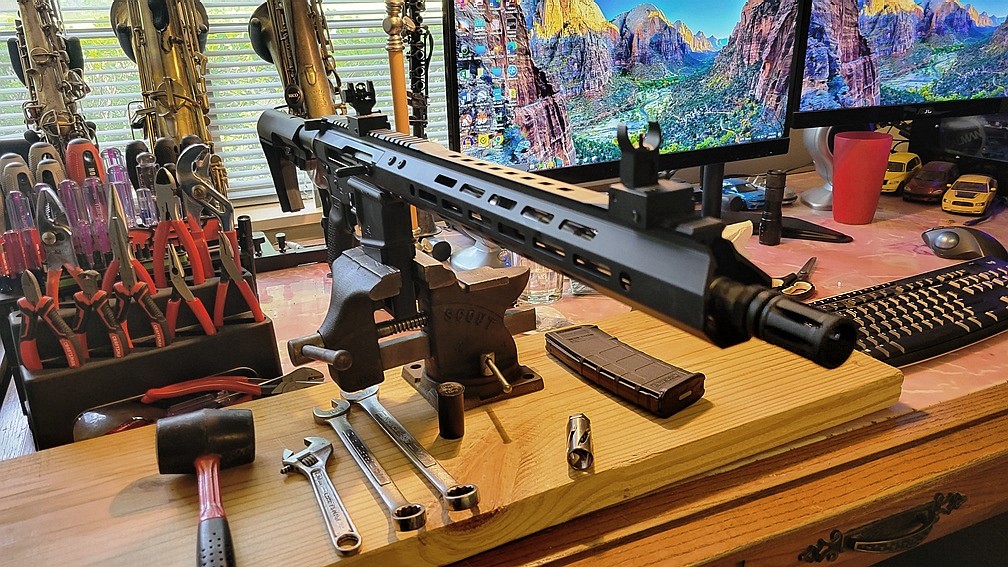

I finally finished my lightweight rifle build. Upper is from Bear Creek Arsenal. It has a 16" stainless barrel with an M4 profile to save weight. I remeasured the barrel myself without the flash hider and with the bolt in place to make sure it was legally 16" and compliant with Federal standards for a non-tax stamp build. There is both a right side charging handle and a standard top charging handle. Carbine gas system and buffer. No forward assist or dust cover on the upper. Lower receiver is Aero Precision. I love their stuff. Lightweight MEYBO stock. Magpul Industries MOE grip. Stainless steel hammer and trigger from Anderson Manufacturing. Optics are just iron sights. These are flip up Feyachi S27 fiber optic iron sights that I got off Amazon.
The barrel came with a kind of blingy stainless steel flash hider. The last step to this build was to replace the blingy flash hider with a mil-spec M16A2 flash hider that also sort of works as a compensator. Using the mil-spec flash hider also allows the standard plastic muzzle caps to fit better. I like using these so dust, dirt and debris don't get into the barrel during storage, transport and while traipsing through the woods. You can see the original flash hider and plastic muzzle cap in front of the vise.

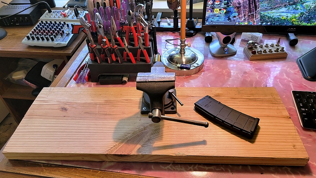

Also, here's a clear photo of my vise setup so I can build and do maintenance at my desk in my office. It's just a 30" long 2"x12" board with a 1950s Scout brand vise that I refinished in gun bluing years ago.

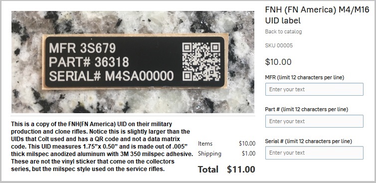

First, there is a metal "UID TAG". It appears most, if not all, US issued M16A4 rifles had these on the right side of the lower receiver. Since they are formatted differently depending on the manufacturer (usually Colt or FN), I chose the common FN tag and then completed it with the information from Texas Machine Gun & Ordnance. The data on the tag in the photo below is for a US-issue FN rifle.

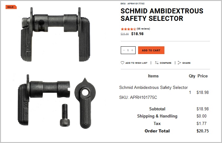

Second is a Schmid ambidextrous safety selector. These were included on some of the later M16A4 rifles. And while included on Colt and FN models, they were mostly all made by Schmid. The only different is that this one is for semi-automatic rifles. I believe the automatic version would have worked with the semi-auto fire control group. But it would have been about a $100 more than the semi-auto version. Plus, it's good to keep everything "under the hood" as semiautomatic in order to avoid the ever-changing legal definition of "constructive possession".

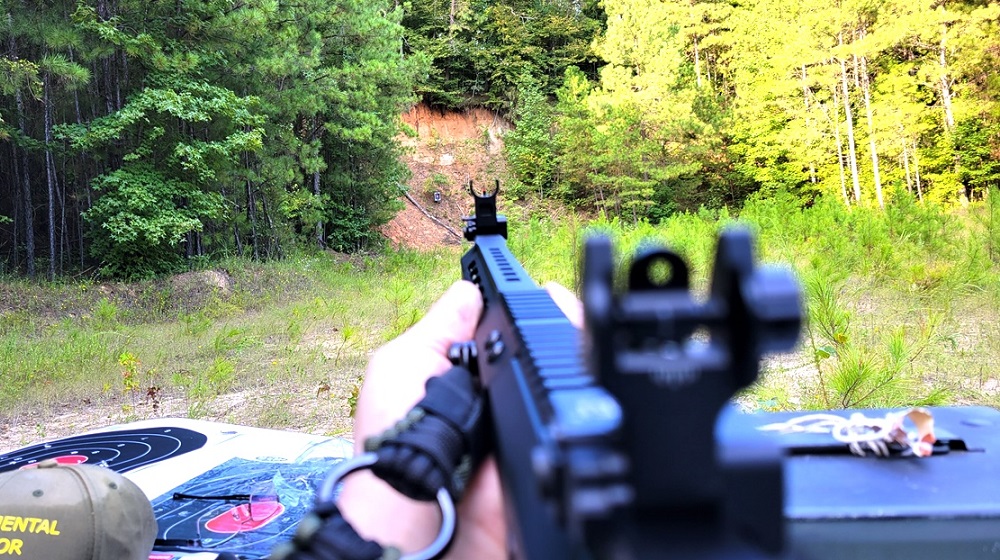

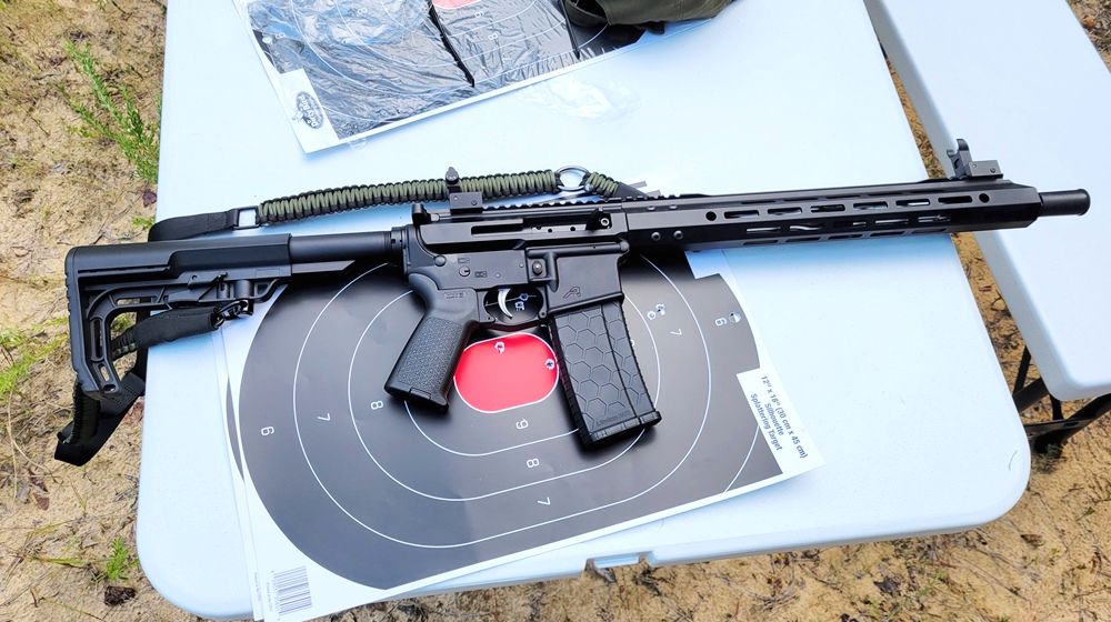

It was time for a little zeroing in with the new lightweight rifle build. I'm at a borrow pit on my wife's family property. The pit is about 55 years old and is starting to get overgrown with yellow pine trees. But it's still a near perfect range, with high walls on three sides.
This lightweight rifle has a 16" stainless steel M4 government profile barrel with 1:9 twist and a carbine length gas system. Chamber is .223 Wylde for accurate use with both regular .223 and NATO 5.56.
I don't have a good photo of the target. But for me in a supported position and my father-in-law in an unsupported position while sitting on an ATV, we seem to be mostly grouping high and slightly to the left on a 50-meter target. This rifle has Feyachi S27 fiber optic iron sights that came in a set. The front site has an M16 style adjustment, but I couldn't get it adjusted properly just using a 5.56 FMJ round as a tool.
So from my initial sight-in with a bore laser, I knew I would be shooting high. The tendency to hit left is likely just overcompensation that both I and my father-in-law naturally make after a lifetime of shooting rifles with heavier trigger pulls. The bore laser was dead on, left to right. And if I aimed a little right and low, I could get the bullseye. I plan to go back to the borrow pit with the right tools soon. Overall, I really like this rifle.

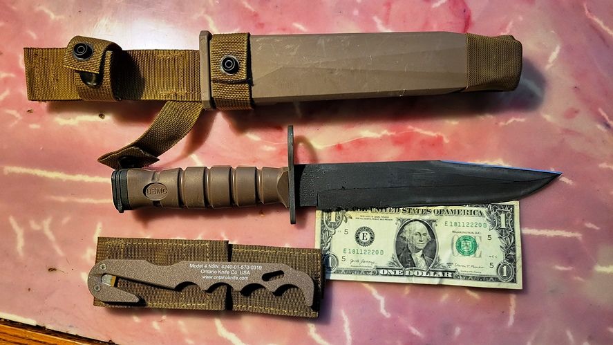

Some of the last parts for my upcoming M16A4 Clone build. These are both original US Gov. issue. While there are some minor scratches of the bayonet scabbard, both the OKC 3-S bayonet and the Model 4 strap/parachute cord cutter appear to be unused. With shipping and sales tax, the bayonet with scabbard was $103.91 USD. The strap/parachute cord cutter was $13.95. Both were made by Ontario Knife Co. which was the original supplier of these to the US military. The entire length of the bayonet in the scabbard is 14 inches. So it's a pretty impressive piece.

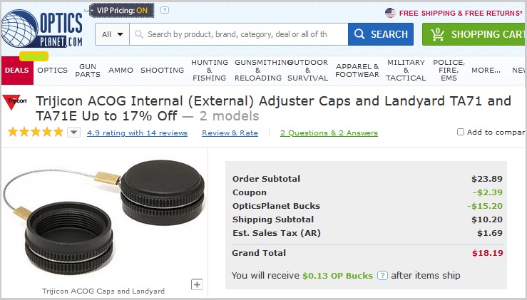

Went ahead and grabbed some ACOG adjustment caps with the USGI lanyard attached. It's a small thing, but will be very visible on the completed rifle.

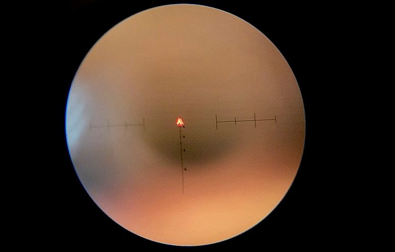

Here's a shot of the reticle. It's hard to focus on with my cell phone. The delta in the middle is illuminated by the fiber optics, just from the light in my office (only lit by window light). It works pretty well.

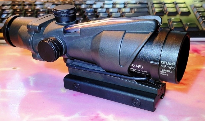

I've added a "Killflash" to the front of it (as seen on the Marine Corp ACOG above), which doesn't appear to effect viewing at all. An adjustment cap lanyard and rear lens cover are on the way. The real test will be to determine if it holds zero after putting a hundred rounds through the finished rifle. So we will have to wait and see.

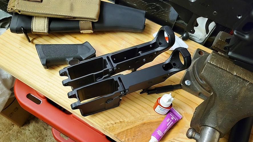

Getting ready to begin my M16A4 clone build. You will have to pardon the mess. I decide to do this in an "ad hock" storage area instead of on my desk. My medical treatments are going well, so it looks like I'm not going to be home-bound during recuperation like I thought. I might as well get this build underway. God seems to enjoy blessing fools like me. And I'm very grateful I'm not lying in bed in pain right now.
I've already found one issue. I like to use a magazine well block to hold these rifles as I build them. I usually use an unfinished 80% lower when working on the upper, since an unfinished 80% lower is much tougher than a regular finished lower. But this M16 upper will not fit on it without machining out the rear pin well on the 80% lower. The reason is that the milspec M16 upper is designed for a full automatic lower that has the back of the trigger well machined out a lot more than on an AR15. This and other similar M16 uppers will fit on a finished AR15 lower as long as there is no "gate" between the safety select location and the rear pin well. You can see what I mean in this photo.
I don't want to risk damaging my special M16A4 clone lower by using it to support the upper during assembly. Luckily, I have a junk completed lower that I messed up during machining. I will use that instead of the unfinished 80% lower. The clone lower will be completed separately from the upper to avoid damaging it.

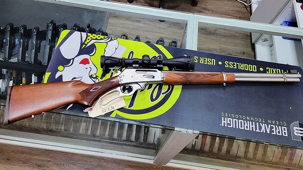

My 30-year-old son has been looking for a lever gun, but the price of those things has gone out of sight. While doing some solo Christmas shopping Friday, I stopped by my go-to gun store and they had this Marlin .30-30 they had just taken as a trade-in. And the price was about the same as the other stores wanted for a worn out Winchester. Wow! And right now, Marlins are often more expensive than Winchesters. I took a photo and called my son. I told him what is mother and I were planning to spend on him this Christmas, and if he wanted to fund the rest, he could have an EXTREMELY NICE lever gun. He met me at the gun store about twenty minutes later. He's been smiling ever since.
Oh.. And that's a Leupold scope on it. It's about as clear as a sunny spring day and has about a foot of eye relief. "Wow" doesn't even cut it.

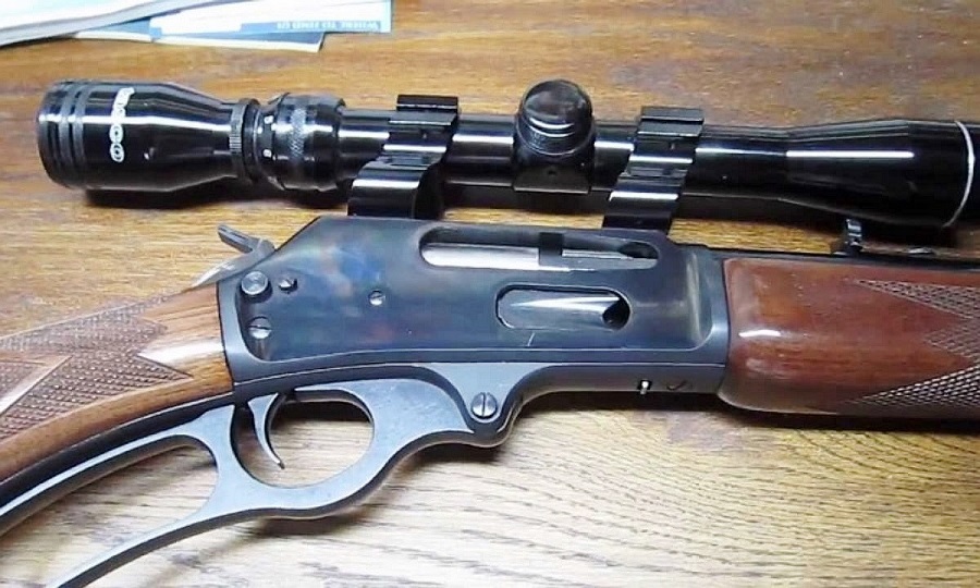

When comparing my son's new Marlin Model 336 .30-30 to my 1985 Marlin Model 336, he noticed that mine had "see-thru" scope mounts that allow the iron sites to still be used. He wanted a set, but the main US company that made them, Kwik Site, is no longer in business.
Stock photo similar to mine.
Luckily I found that while not selling directly, Kwik Site continues to make them for other manufactures. Since his .30-30 came with a factory Weaver rail and an awesome Leupold scope on it, I was able to find the Weaver version of the same US-made see-thru mounts being sold by Leupold. The part number is 55880. So there will be a set under the Christmas tree for him.:)
