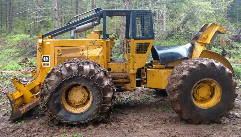

I grew in a family of logging contractors. They were paid to go off-road every day. A log skidder is made out of 3/8" to 3/4" steel plate and can go through almost anything. But if you rough-house it too much, you will break something. I know. I've done it. And I've had to fix it when others did it. A Raptor or TRX cannot compared to a log skidder when it comes to off-roading. For most folks, things are going to break now and then unless they just creep along.

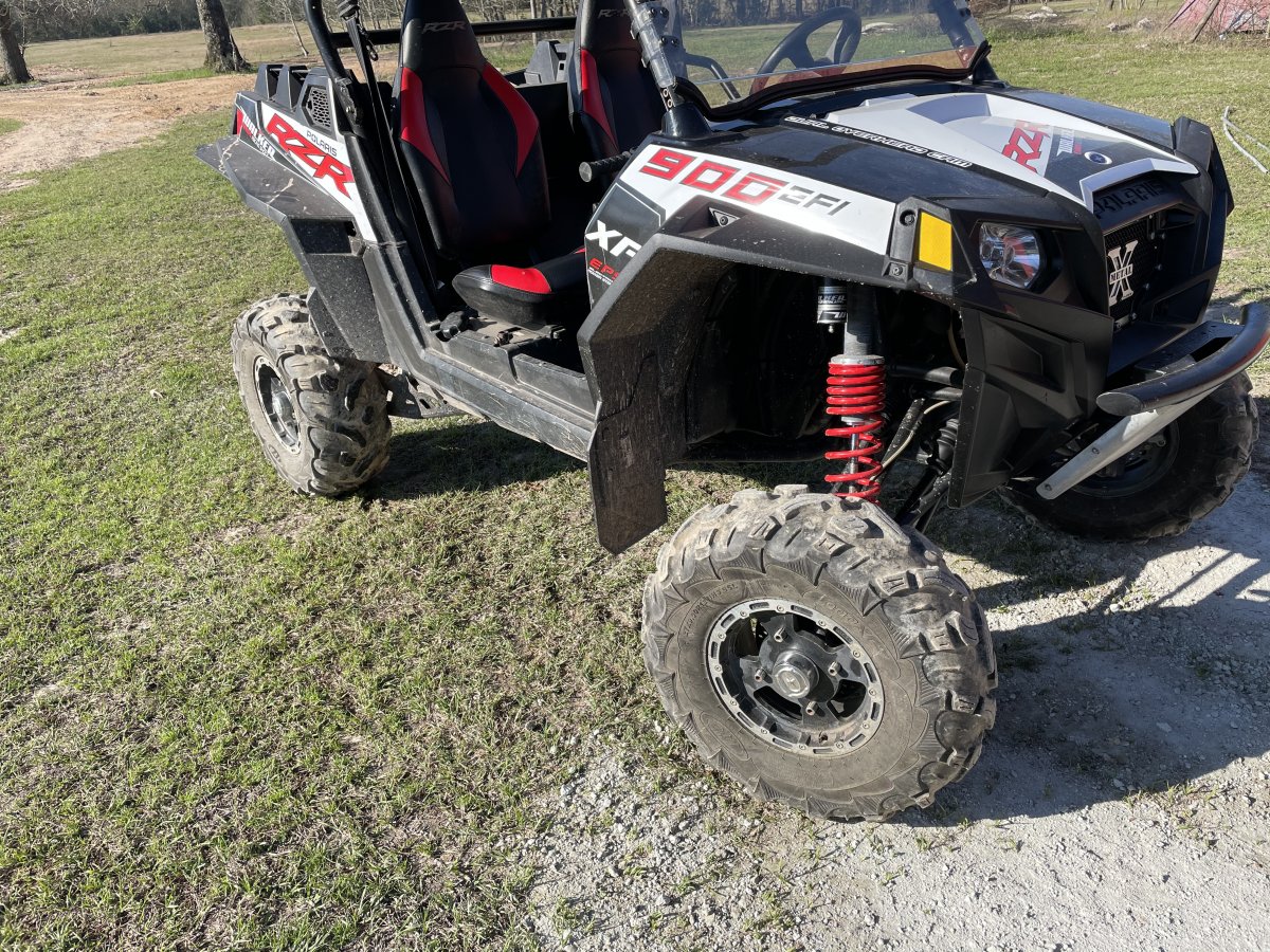

My Raptor is out of warranty now so I doubt I get it off the ground. I just been getting those trills out of my RZR.
I hate saying it. But doing your off-roading with a RZR or similar is likely the smartest way to go. Those things will go almost anywhere. And if you break it, you don't have to take out a loan to fix it. :)(y)

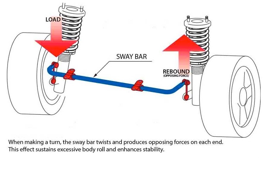

Sway bars do exactly what their name suggests…they help eliminate sway….aka body roll in hard turns. They do however limit flex in off-road flex situations. It’s a trade off.
So basically if I was to get off intestate helps with the sway ans I’m wording if it will help on overpass expansion joints sometimes it almost feels like the ass end hops over those.
If both back wheels bounce together, it will not help. But often, just one wheel bounces. It will reduce that a substantial amount.
