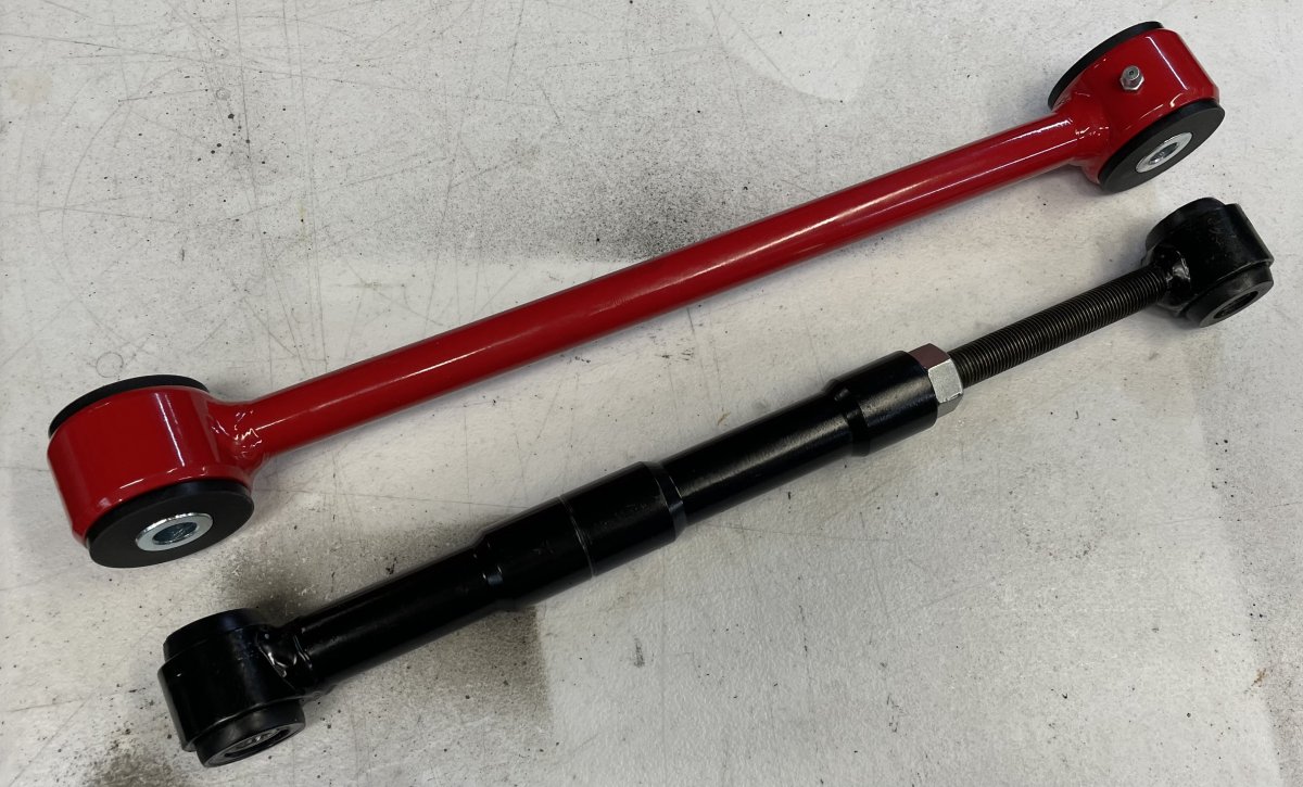

I started in the middle holes, but moved to the firmest setting. I also had to remount the upper links with the correct sleeves because I didn’t have them when I installed it. They include two different ones and neither is right for the TRX. They give you one that is the correct I.D., but too short and the bushings get crushed when the bolt is tightened. They also give you one that’s the right length to prevent the bushing from collapsing, but it has the wrong I.D.
These are what I bought to solve that:
These are the bolts you also need to order:
Overall it’s been a worthy mod. Reduces the body roll, fixed the wayward, bouncy feel over railroad tracks, and even took care of some of the lean.
I wound up buying some fixed length end links from Core4x4. They have grease fittings and just seem a lot better quality and actually come with the hardware you'd need to order separately if using the Hellwig links. Unfortunately I can't put them on until I get my suspension noise sorted out, but I'm pretty excited!

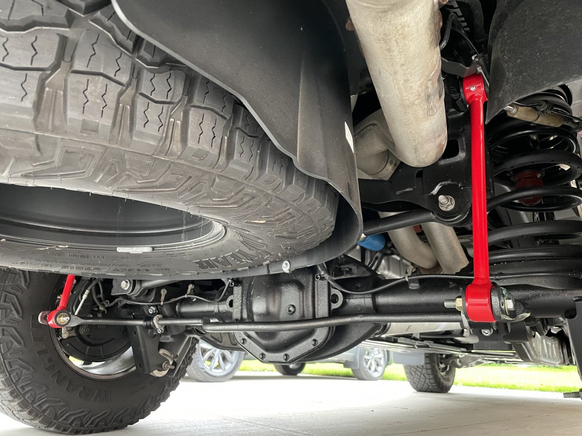

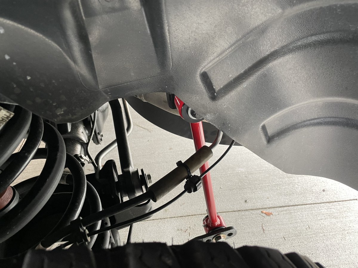

Speaking of, I wound up putting it back on today because I don’t know when the parts to fix my suspension will hit the dealer, and I was tired of tripping over it.
The Core4x4 end links are pretty beefy and everything went together great.
Yes, would highly recommend to anyone considering the Hellwig. The stock Hellwig parts and the hardware they give you (which isn’t right) is all kinda Mickey Mouse if you ask me.

The Core4x4 end links are pretty beefy and everything went together great.View attachment 3331View attachment 3332View attachment 3333
