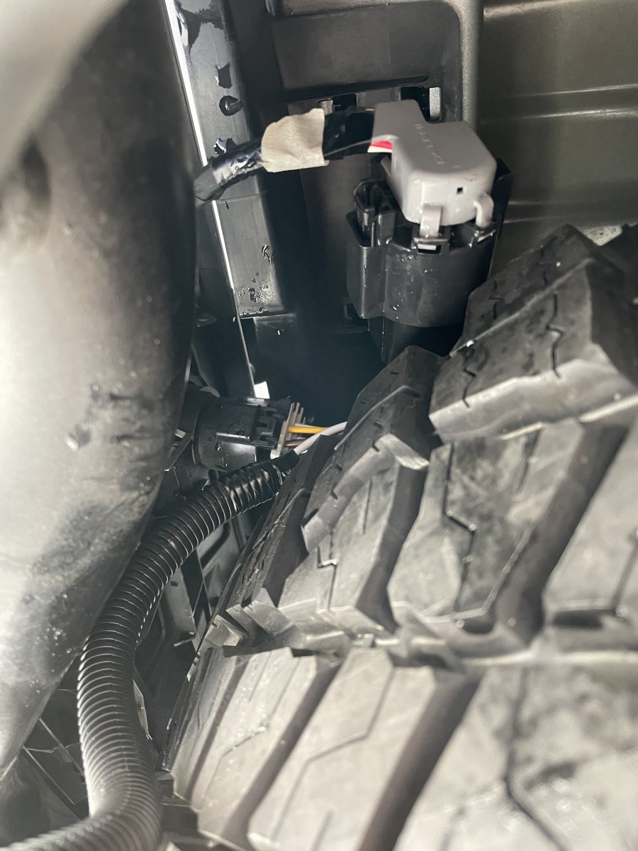

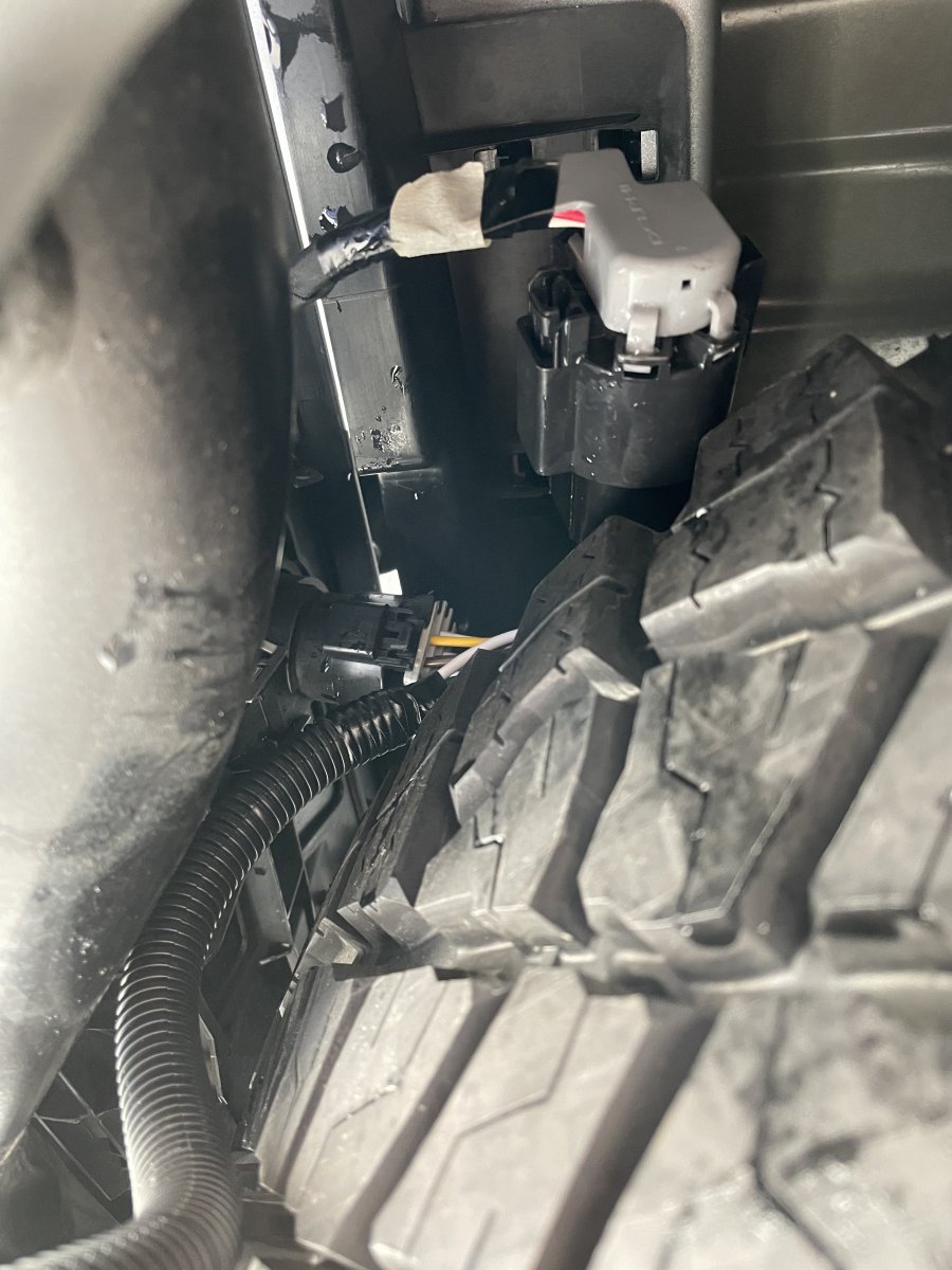

One end of this will plug into the truck’s 7 pin trailer connector wiring. Plug the opposite end of that harness back into the stock connector, lop the 5 pin plug off, and there’s my reverse and park light signals.
It’s tight for clearance around the spare but still looks like it’ll work. I haven’t had a chance to test fit it yet. Maybe this weekend if it doesn’t rain / snow the whole time.
The plug and play harness presumably would just eliminate the steps I describe above to obtain the signals. Which is definitely going to be attractive to some.

Yup, the 5th pin is the reverse light signal. This connector is mainly used on boat trailers. Mine came with it. In that instance there are no backup lights, it’s only purpose is to trigger the surge brake lockout when backing up. But it’ll trigger reverse lights just the same.
Test fit the Curt harness. Fits fine. Slight pain to reach up there but doable.
Also found that the stock plug was full of water when I first disconnected it. No wonder these things don’t last around here.
