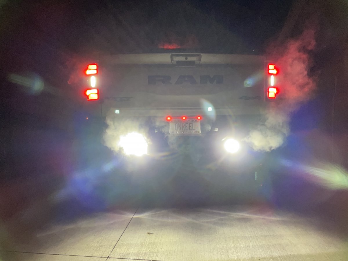

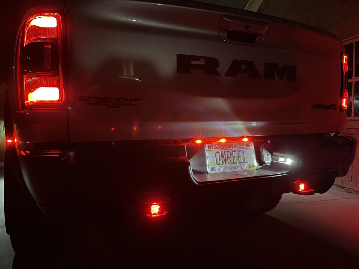

I finally got my harness tested and it seems to work as intended. There were no errors or warnings that popped up but i just tested in my garage. I can’t get them fully installed till I get my tow hooks painted which will hopefully be this weekend.
For reference as i stated before i bought a 4 pin curt adapter, not the 5 pin so i had to tap the reverse lights off the center white wire on the 7 pin. This is a bigger wire than the wires in the 4 pin so I used 16 gauge wire and also added an inline fuse on the power because Diode Dynamics said you should always put one. Right now it has a 20a fuse but I’m going to drop it down to a 10a. Instead of cutting off the 4 pin plug i decided to use it and bought a 4 pin trailer side plug. I connected the ground to the ground and then wired the red back lighting (blue wire on the Duetch connector) on the pods to the Green and yellow wires which are left turn signal/right turn signal and brakes.
Unfortunately I didn’t take pictures as I was doing this and now everything is taped and covered with wire loom so I can’t give much of a step by step but is for the most part straight forward.

@quietpeen you're officially fired for not taking photos or video! 🤣🤣🤣 Just kidding. Great job and great description. I can't wait to see it all done.

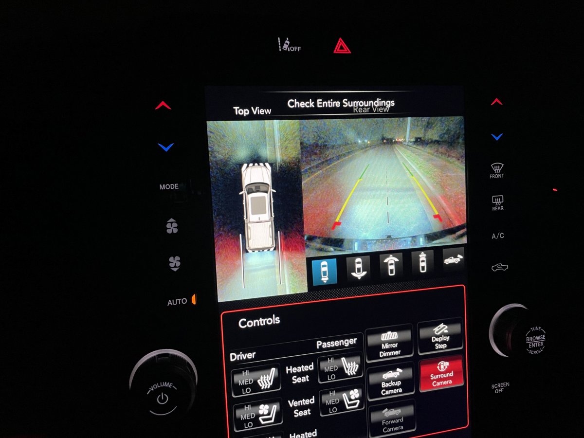

Thought this was pretty cool. Definitely a huge improvement. Hell, in the overhead view, the reverse lights are now brighter than the headlights!
