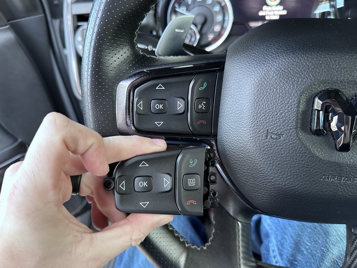

Got the elusive new switch.
Harness landing tomorrow. Should be able to get everything installed then. I’ve had a lot of stuff apart on this truck but the steering wheel / airbag is not one of them so I’ll have to take my time with that. Center stack also needs to come out but that’s easier.

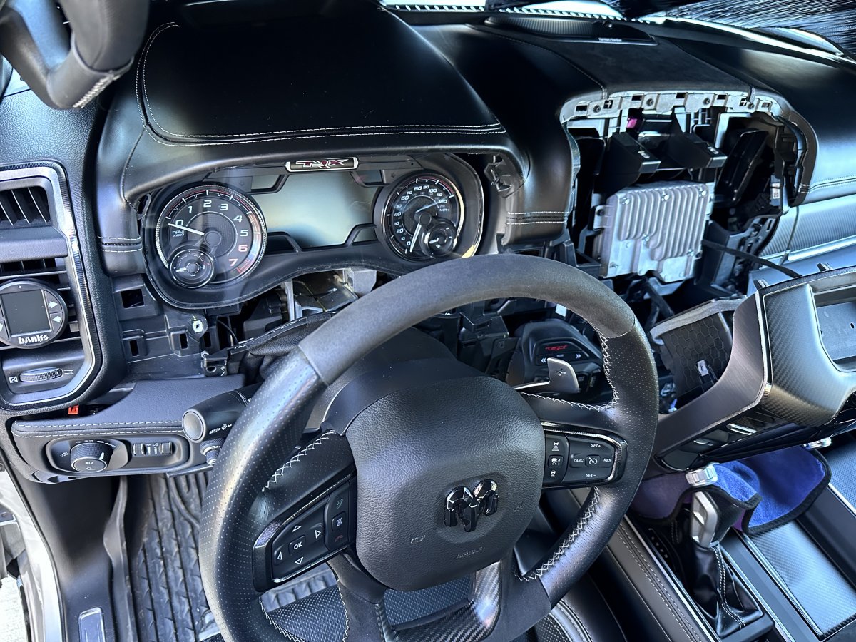

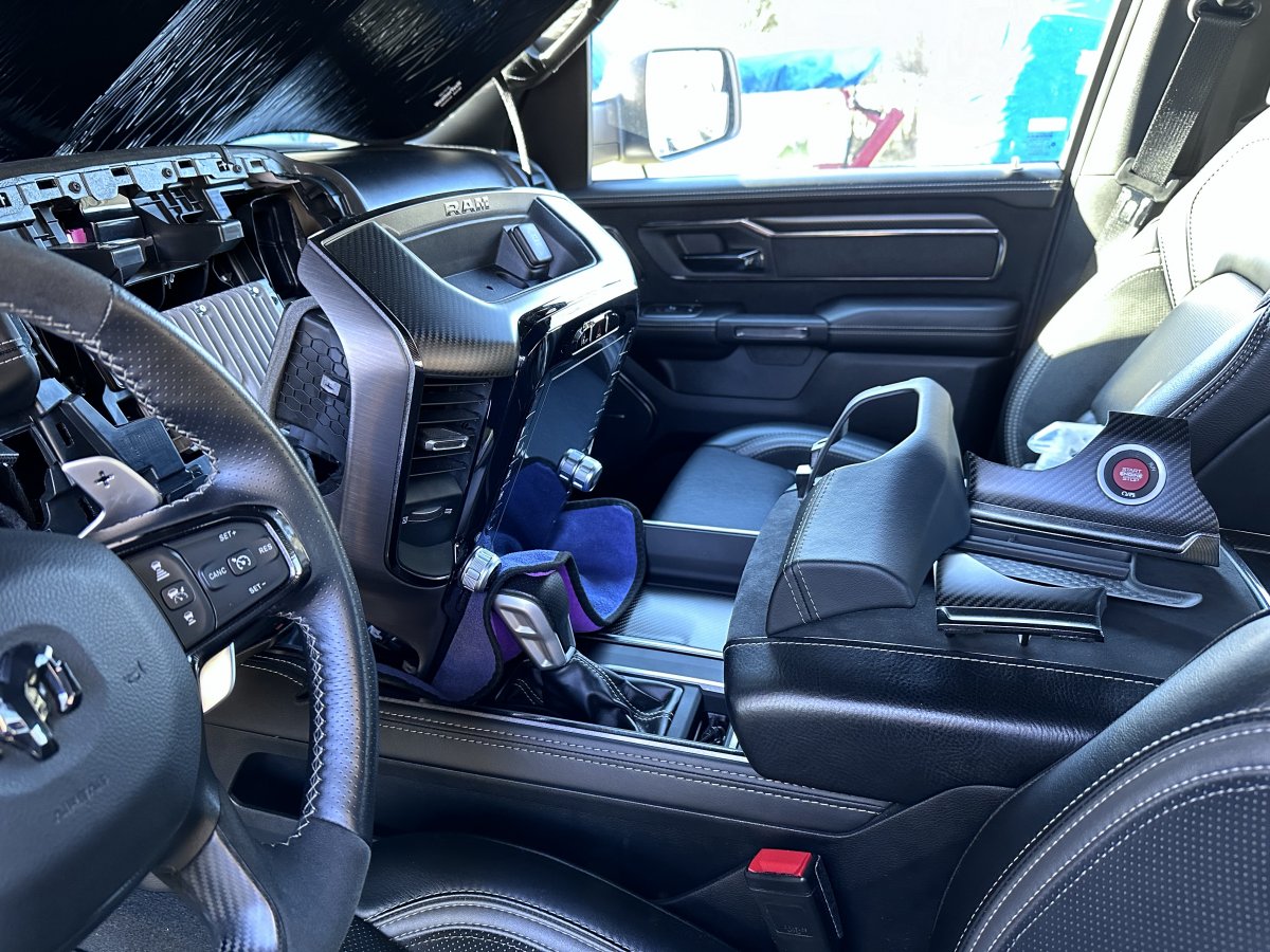

Postal service failed me today and the harness is another day out. Already cleared my schedule to do this this morning so I pressed on and did everything I could.

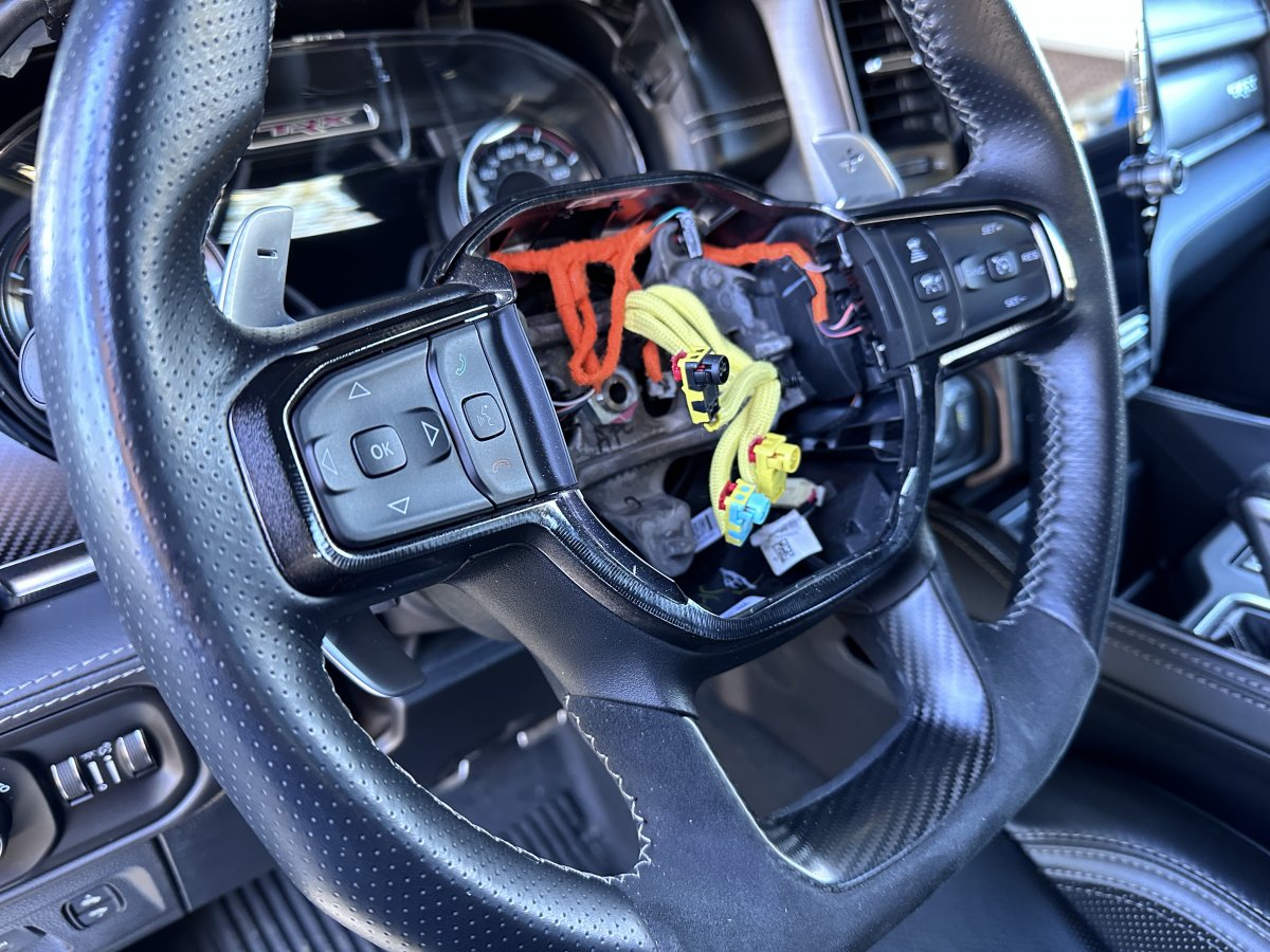

Airbag fought me a little but not as bad as I expected. Took about 45 minutes all in to remove, swap switch, clean and re-assemble. Wasn’t getting any traction with the T handle or my valve stem core tool (which was also mentioned as a good option) so I just kept trying random shit. An S2 square bit driver did it eventually. Frustrating when you can feel the stupid spring slip off of every tool you try when you get it so close.
Then I moved on to getting all the trim freed up around the cluster and it’s ready to come out. Cluster bezel, screen, CF trim on either side of the cluster, TRX button trim, headlight switch, and knee buster all have come off or come down to get the fake leather boot around the steering column out of the way. Then it’s just 4 screws for the cluster.
Since I did all this in advance it should only take another 10 minutes to install the cluster tomorrow and re-assemble everything.
