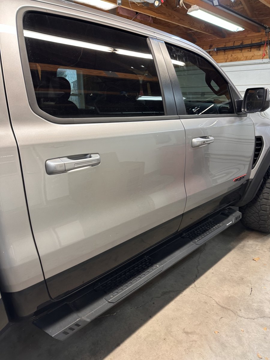

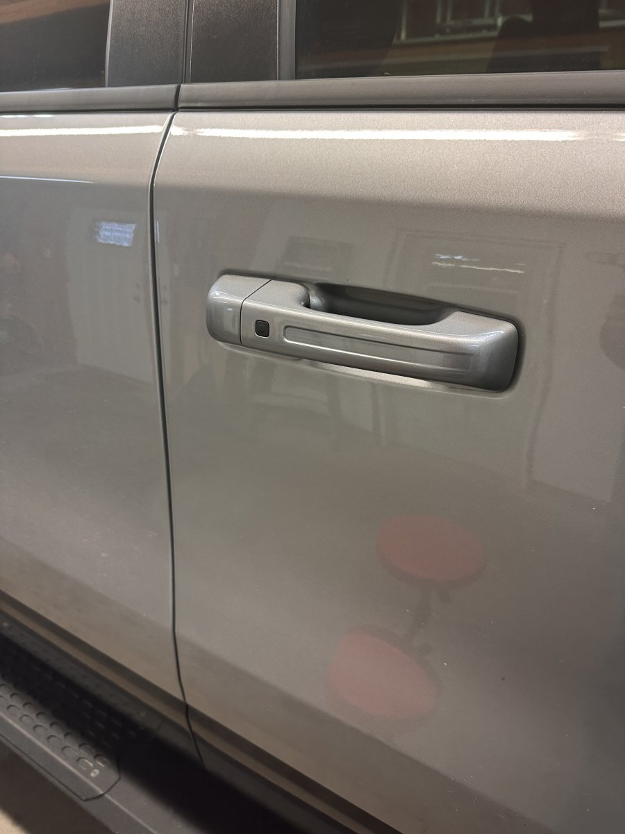

and since I didn’t have color matched door handles had to replace the rear door handle also. Not that I’m complaining about that. I think color matched looks so much better.

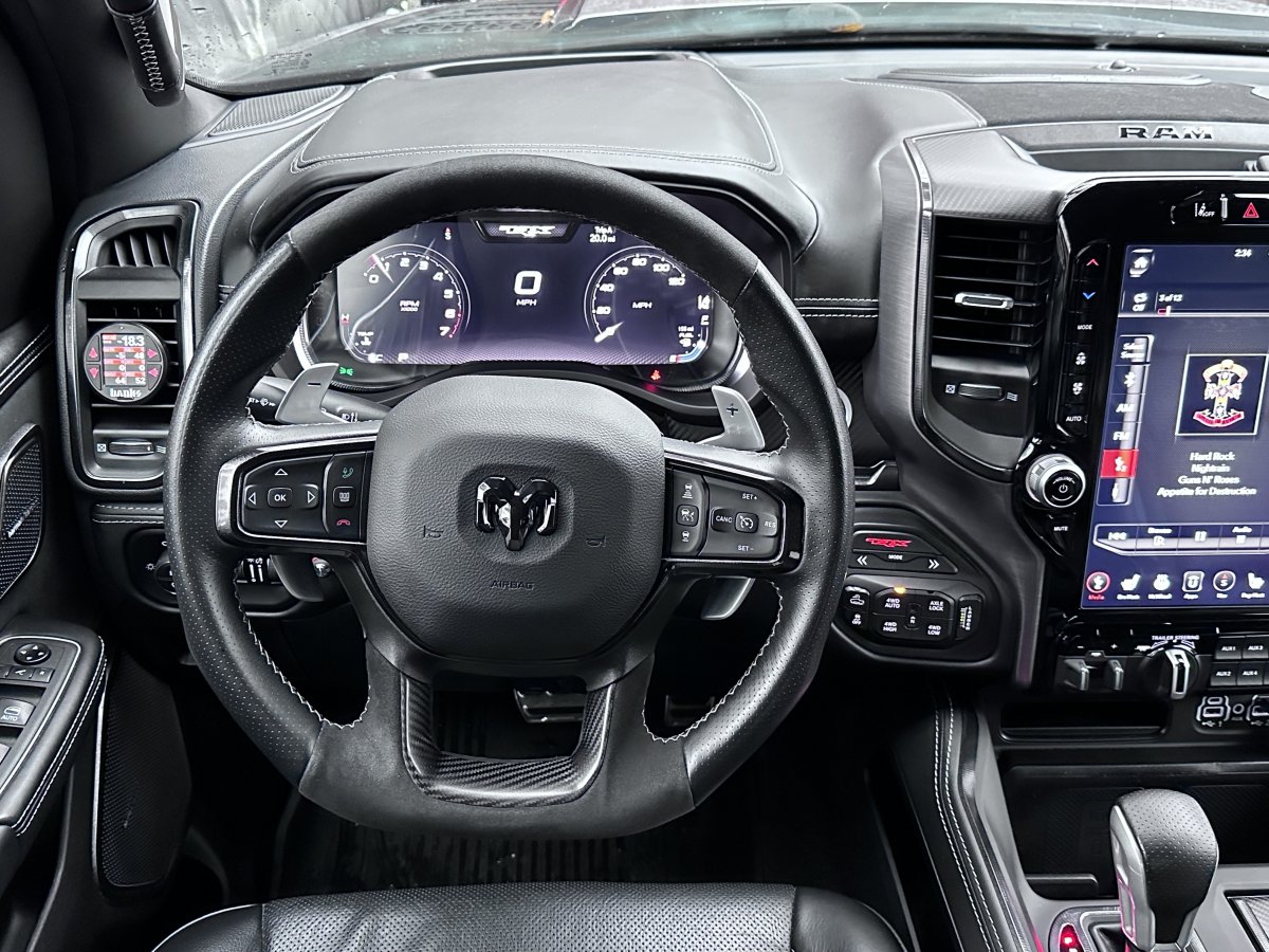

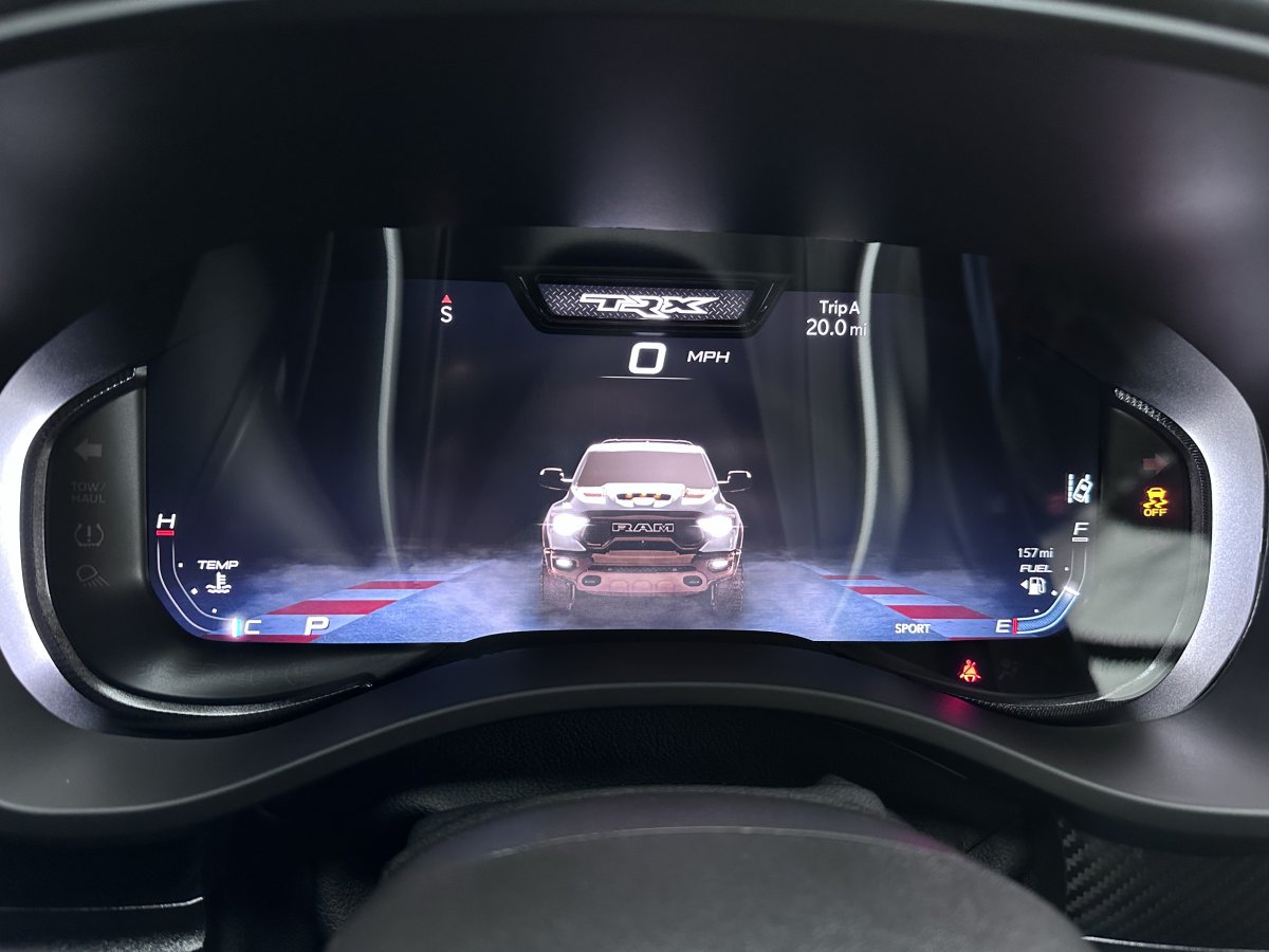

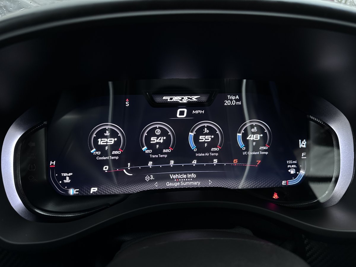

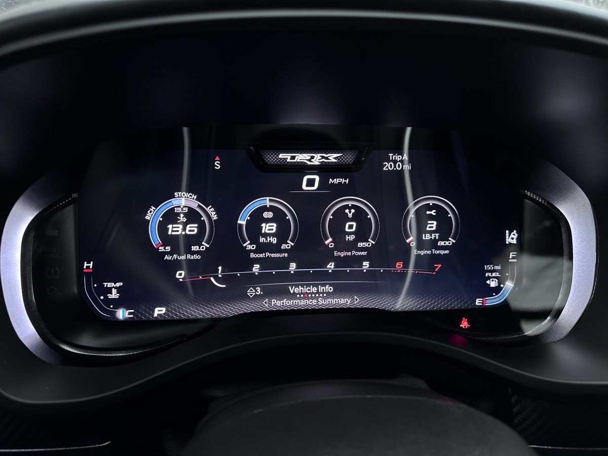

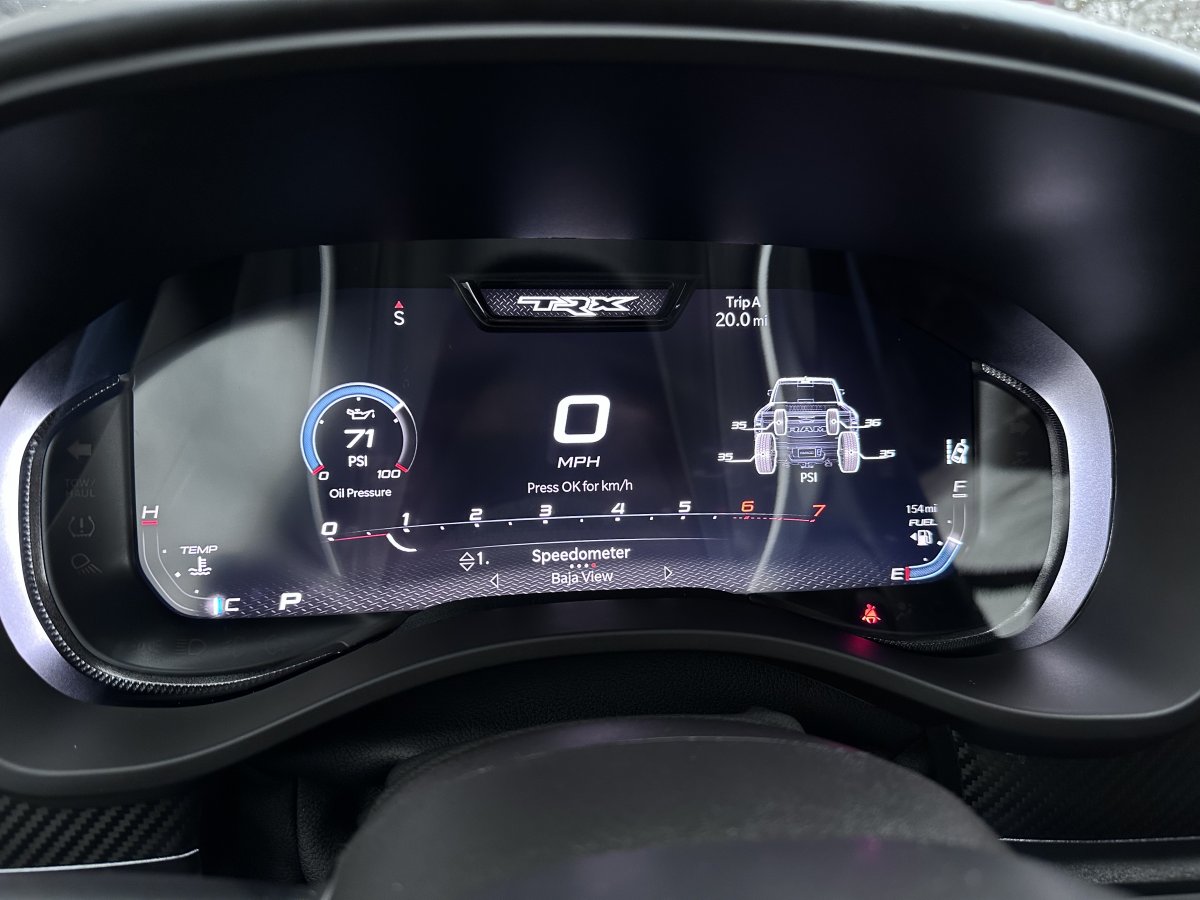

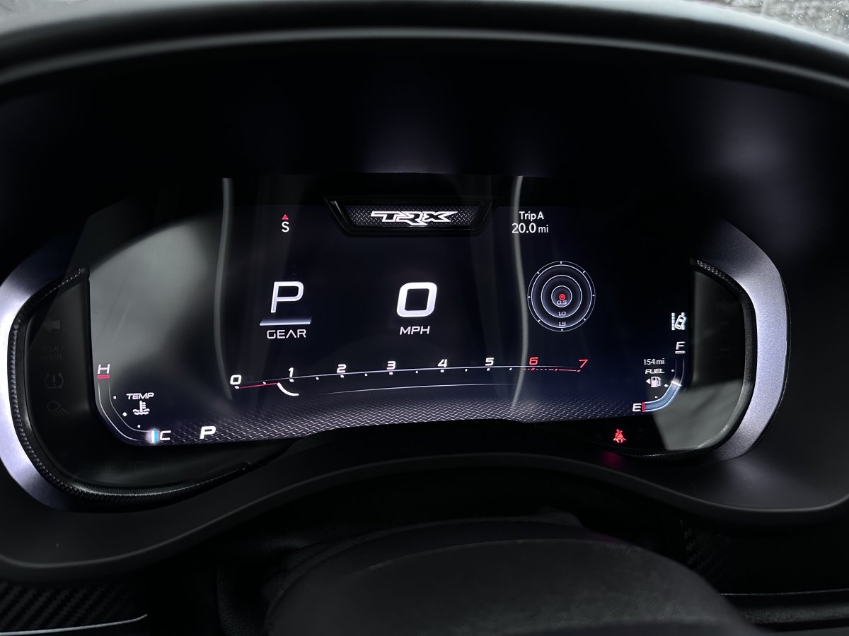

Cluster swap turned out pretty good. Unfortunately the tile button I worked so hard to install isn’t actually doing what I need it to. It’s still behaving like the old voice command button. Otherwise everything works and she’s a beauty.
looks amazing but now worried that the new switch is not working as planned
Yeah, hopefully we’ll get it figured out. Without that button working correctly I’m missing this view with the configurable tiles. I do want it.

got the passive entry done today and made all the changes with AlfaOBD and everything seems to work as it should. Needed to run to lowes and had a check engine light. When I got home i scanned for faults and all seemed to be from when i turned the truck on with things unplugged. I cleared all faults and started the truck and no check engine light. Going to see if it comes on again tomorrow and if it does revert my changes back with Alfa in case I accidentally changed something I wasn’t supposed to.
With that does the check engine light apply to all faults and not just issues with the engine?
I am under the impression the CEL is only for powertrain stuff. Over the course of messing with stuff I’ve had other codes in the system (mainly BCM) that didn’t trigger it.
i was told that the engine light covers codes other than just the engine, but not all faults turn on the light which makes sense because some of the faults were from stuff I did 2 weeks ago

I can tell you the cel is not limited to power train. There's a ton of other things that trigger cel. Including but not limited to electrical issues un related to power train. Such as a window control module that applies voltage to window control when the vehicle is off.
Never saw a B code trigger a check engine light. Imagine failing smog because of a body fault. Some U (communication) codes do but only if they are related to the powertrain.
I'm now pretty sure it was my ambient temperature sensor that trigged the CEL. I do remember turning the truck to on so I could roll the window up on the drivers door and I did that while the harness for the mirror wasn't connected. Some of the other codes were from turning the truck to on with the passenger side front door not plugged in but that didn't trigger a CEL.
That makes more sense. Think that would be a “U” code and it does relate to the powertrain. That temperature data goes from the BCM to the PCM.

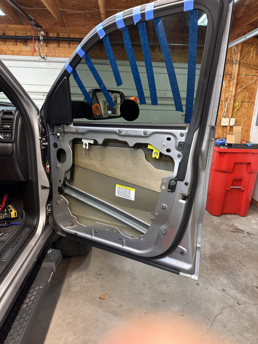

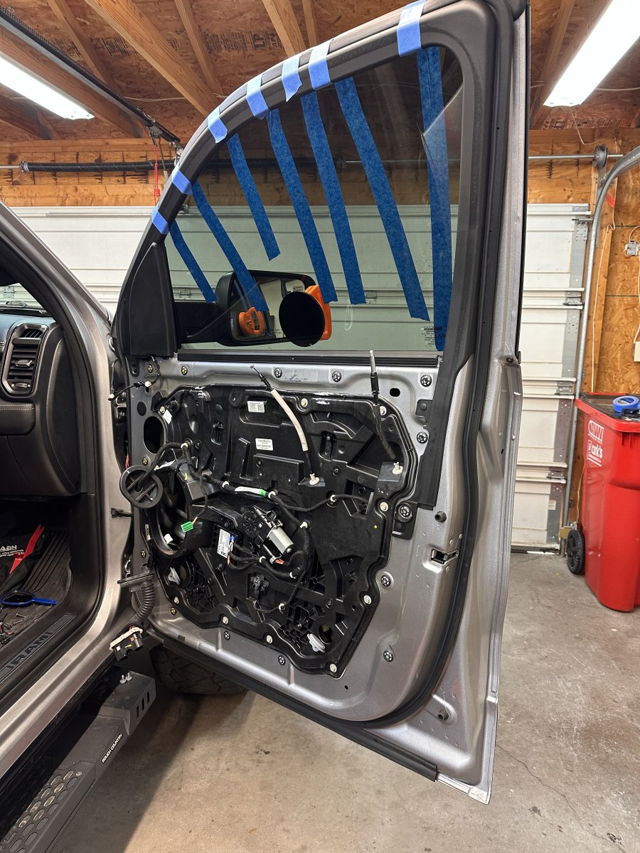

still no CEL so I consider this a finished and successful mod. Adding passive entry is overall not that complicated. Gutting the doors can look daunting but once you get through the 1st door it makes so much more sense and the 2nd door seems a lot easier.
