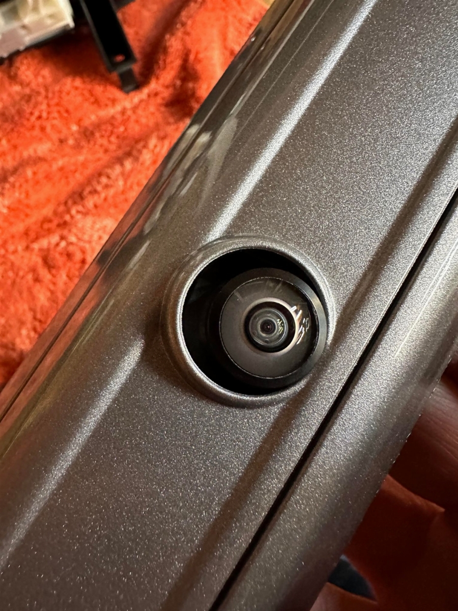

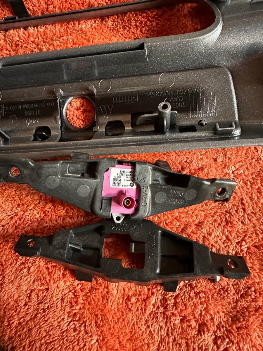

Oh here is something else we learned in this process. There is a difference in size and mounting bracket on the surround view camera vs. the regular back up camera in the tail gate handle. So if you are swapping out your tailgate handle make sure you get the part # that matches for your camera.
here is my regular back up camera in its mount beside the mount for the surround view camera
This is the difference in size of the camera.

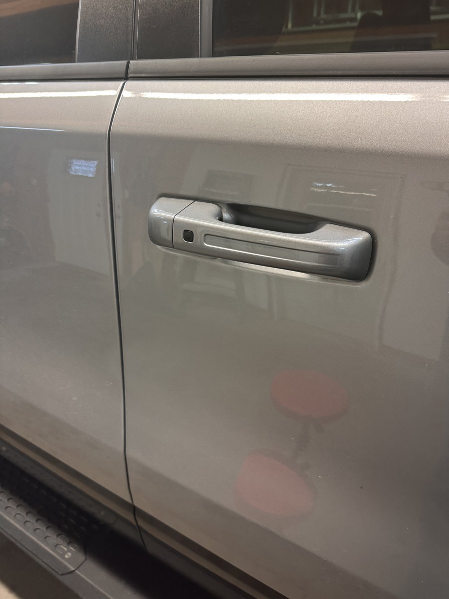

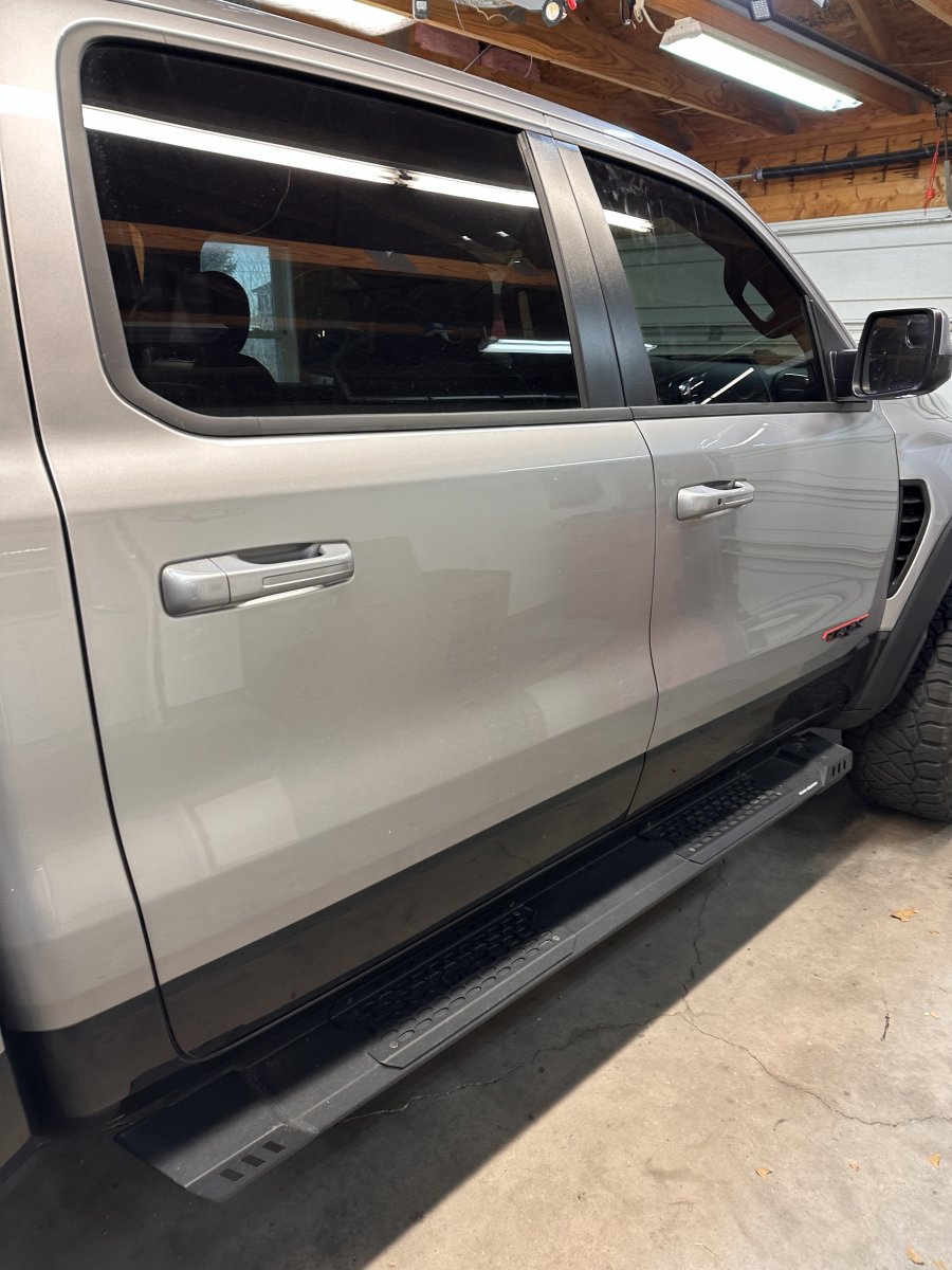

and since I didn’t have color matched door handles had to replace the rear door handle also. Not that I’m complaining about that. I think color matched looks so much better.

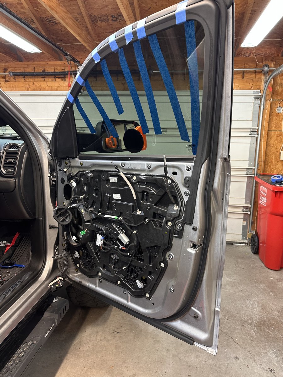

You pulled the carrier plate just to swap the door handles??? And you didn't add sound deadener like dynamat when you were in there???
Are you nuts?
That carrier plate is a PITA to change out. I have done it a few times and it sucks!

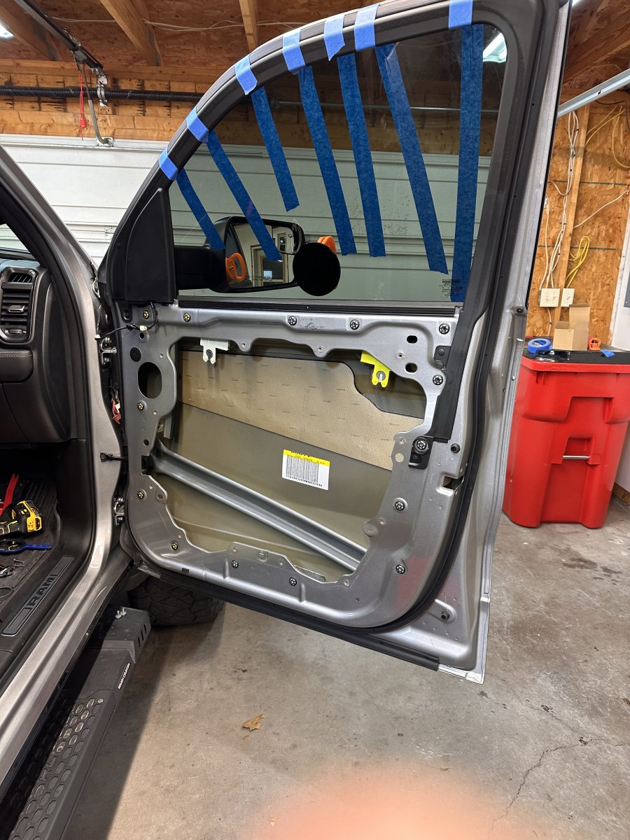

Yes but no, I pulled the carrier plates to add passive entry(had to pin and run the custom harness from Jimmy07). On the 5th gen the handles come off very easy without having to dismantle the doors.
I did think...........damn this would have been a good time to add dynomat when the first one was apart :ROFLMAO:
The doors are deadened reasonably well stock. If you ever do a stereo upgrade you can feed a lot of material in through the speaker hole. Avoids removing the carrier and still makes a big impact.
Ha forgot to get back to this one. I pulled all my carrier plates to do my dynomat/killmat install and I if I had to do it more than once Id rather not do it. That is a lot of work!
