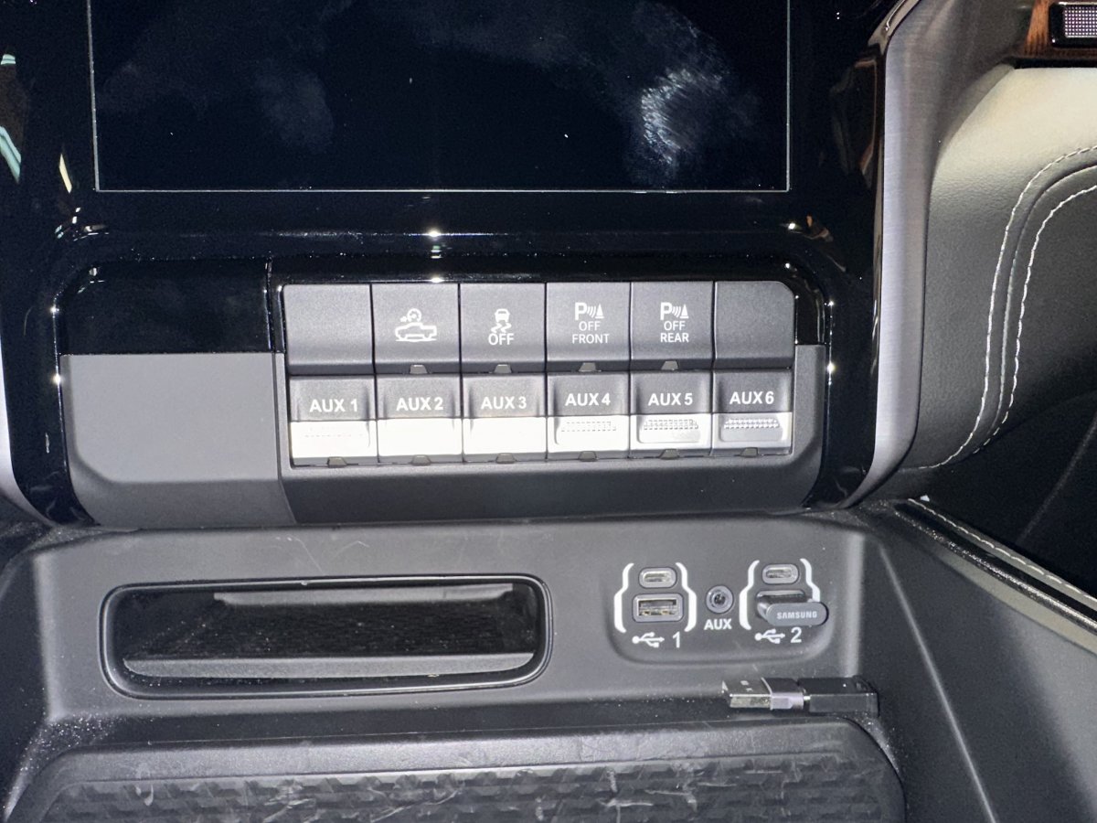

I installed the switches on Saturday. About a month ago I made the 3 internal harnesses and installed the park sense module behind the drivers kick panel. The one harness gives the module power and ground and goes to a can block. The rear sensor harness went from the module to a plug under the drivers seat and 6 pins had to be put in the connector. The front sensor harness went to a plug up under the dash on the drivers side and 8 pins had to be put in the connector.

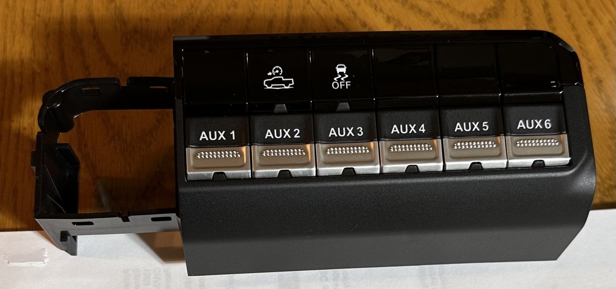

my truck came with the aux switches so luckily I don’t have to do anything with that. I just had to install the new switch panel that has the buttons to turn off the front and rear sensors. Here is the panel I took out.
what I do find interesting is on this panel the top buttons are the shiny piano black, but on the new one they are not.
I started seeing that change on the 2022s. I suppose the matte black will hold up better if you use the switches a lot.
