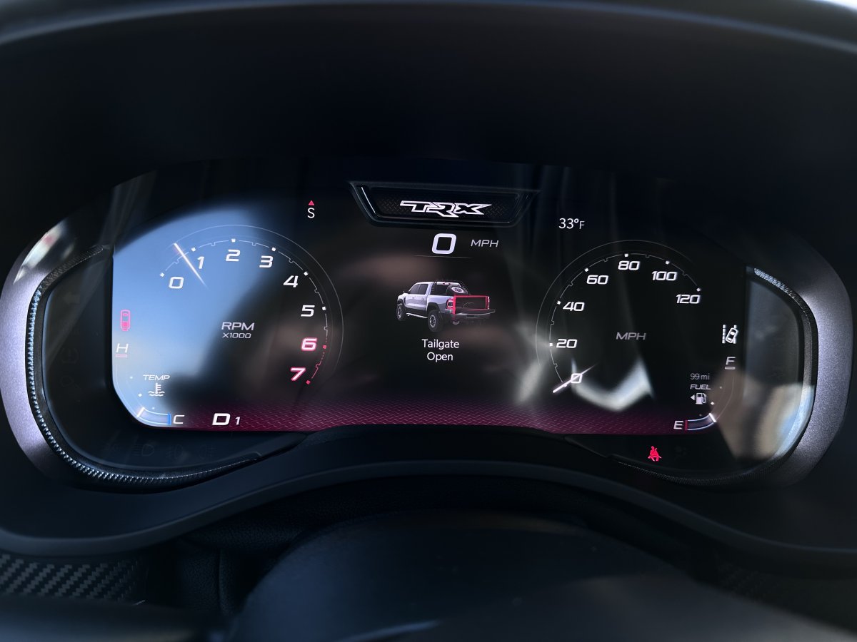

Oh, and because @quietpeen asked awhile back, I don’t currently have the tailgate animation on this cluster. I have the ajar light but not the image. Which is odd because it worked on the old one and I’ve done nothing with those settings since the swap.
I will revisit at some point because I think there’s more than one for the tailgate alert.
View attachment 4014I will revisit at some point because I think there’s more than one for the tailgate alert.

Also, didn’t think to put it in gear but that did trigger the tailgate alert so we are good. And it’s a TRX.
Now if only the power steps had a TRX cartoon as well. Fat chance on that since they never offered them on the TRX.

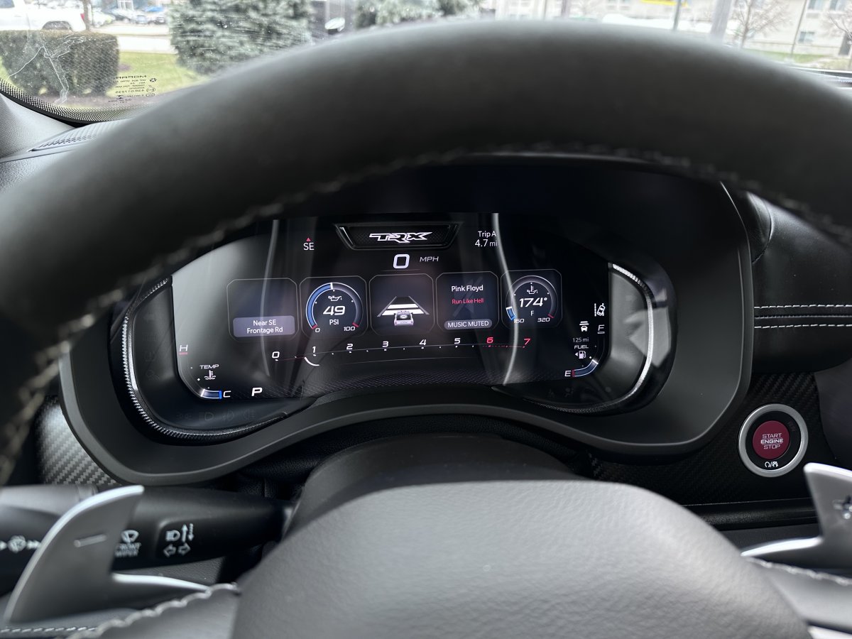

Tried a few more configuration changes but the tile button is still activating the VR. I am starting to think this is a conflict with UC4.
Thinking about it…On the 2021 you have the green phone button, the center voice recognition button, and the red hang up button. On the 2023s with the digital cluster the top button does double duty, both VR and phone. If UC4 doesn’t support combining those two functions, it may still be “looking” for that VR button and overriding what should just control the tiles on the cluster. Whereas a 2023 radio might know enough to ignore it?
The fly in that ointment was that you also have 2023 trucks with the 7” EVIC that use the same exact radio module, but the older style switch with separate VR and phone buttons.
BUT then I thought…okay…since there’s an Ethernet connection going from the 12” cluster to the radio, it’s at least possible the radio sees that cluster over Ethernet and automatically combines the VR and phone functions? Leaving the tile button just for tiles.

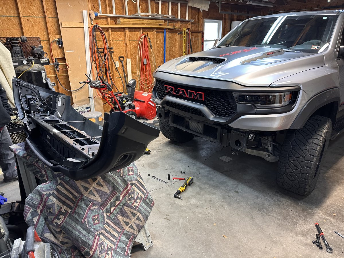

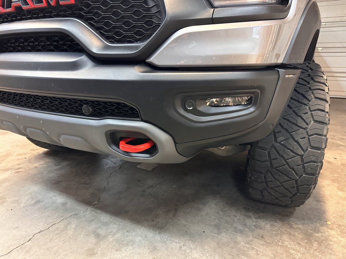

Finally got the front sensors installed today and everything is working. I’m so relieved there are no issues. The front bumper had to be completely taken apart. With two people it really wasn’t that bad and went quicker than we thought it would.
