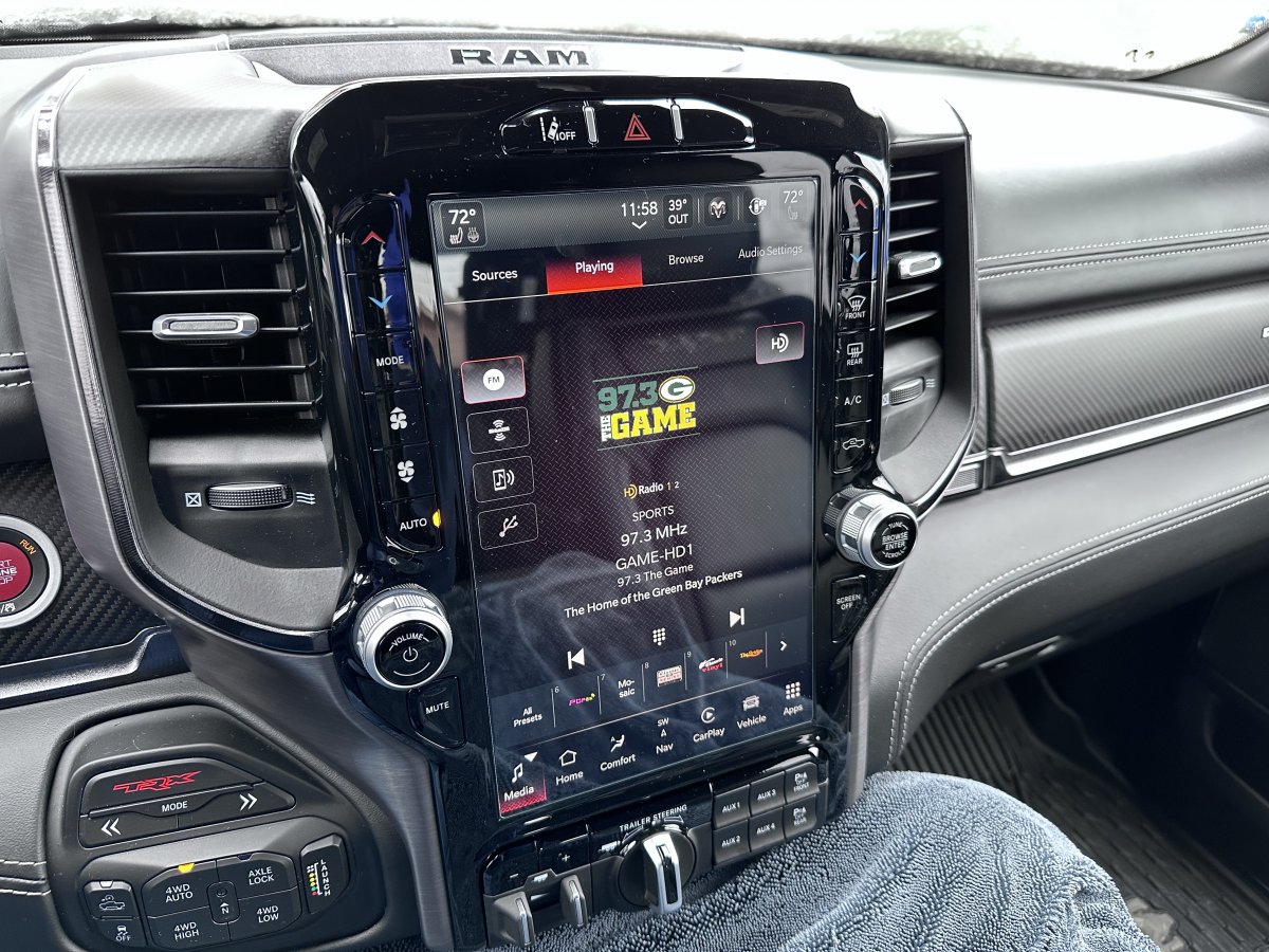

Oh, and I forgot to mention another perk. I have a free active SiriusXM subscription. I dunno if the radio is still on a free trial or if someone is paying but I ain’t complaining.

Nice bonus on the the sirius. Didn't you still have a travel link subscription. If you want that transfered over you will have to call sirius and tell them you changed radios which will zap whatever is giving you radio stations right now.

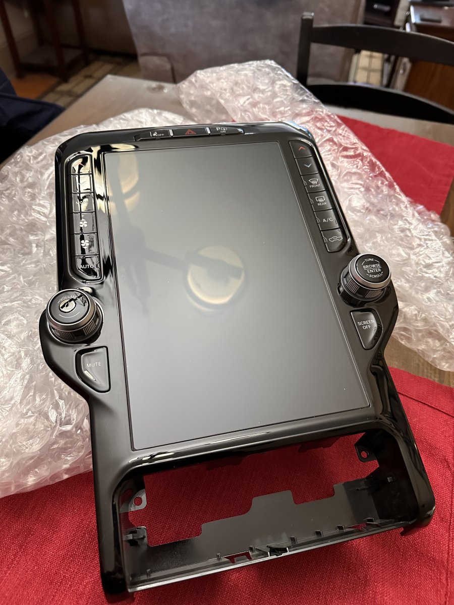

btw, did you have any plugs from the uc4 that didn't have a spot to plug into the uc5 module?
For sure, there’s a few. The old pink and purple cell/ LTE antennas have nowhere to go since the UC5 uses a separate telematics module. The old LVDS cable gets abandoned too. Then I think the other is for internal BT or WiFi and is not needed.

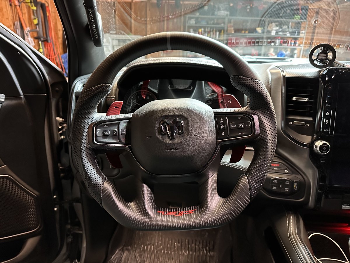

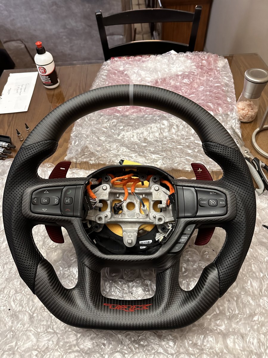

New Steering wheel
It was supposed to also have a carbon fiber bezel but they made one for the regular 1500 with the buttons on the side.
I am currently waiting for them to make the correct one but i just laid the wrong one in it to get an idea of how it will look when the right one arrives.
FINALLY:
A guy commented on my thread yesterday that his tile button was working correctly. I asked him how but unfortunately he didn’t remember the setting. But said he used CDA6 to do it. That was enough to relight the fire to get this working 100%.
I compared backup files from a 2022 TRX and a 2023 TRX, both similarly equipped. This was a breakthrough as it isolated the differences down to JUST the cluster (and a few random option differences that I filtered out).
One line that stuck out was this:
620132C0025B211D601004
The “6” after the “D” is a “2” on non-digital cluster trucks. So on a whim I altered the backup file and loaded it up. Bingo! Better to be lucky than good sometimes.
I then had to ask Jimmy to check on CDA6 to see exactly what I changed and it was this setting:
“ECUConfig 3: Unique Core Steering Wheel” changed from “no” to “yes” by swapping the 2 to a 6.
You can’t access this setting in Alfa so it’s another one requiring an altered backup file to load but I’m thrilled it’s all done now!
nice man, but what is CDA6?
The actual OEM diagnostic software (Chrysler Diagnostic Application). This was only needed to tell me what the change I made was (just so myself and other future swappers know exactly what it’s doing). CDA6 can read the alphanumerical backup lines from AlfaOBD and tell you what setting each position in the lines represent.
You don’t actually need that software to do anything related to the swap now because it’s all been figured out.

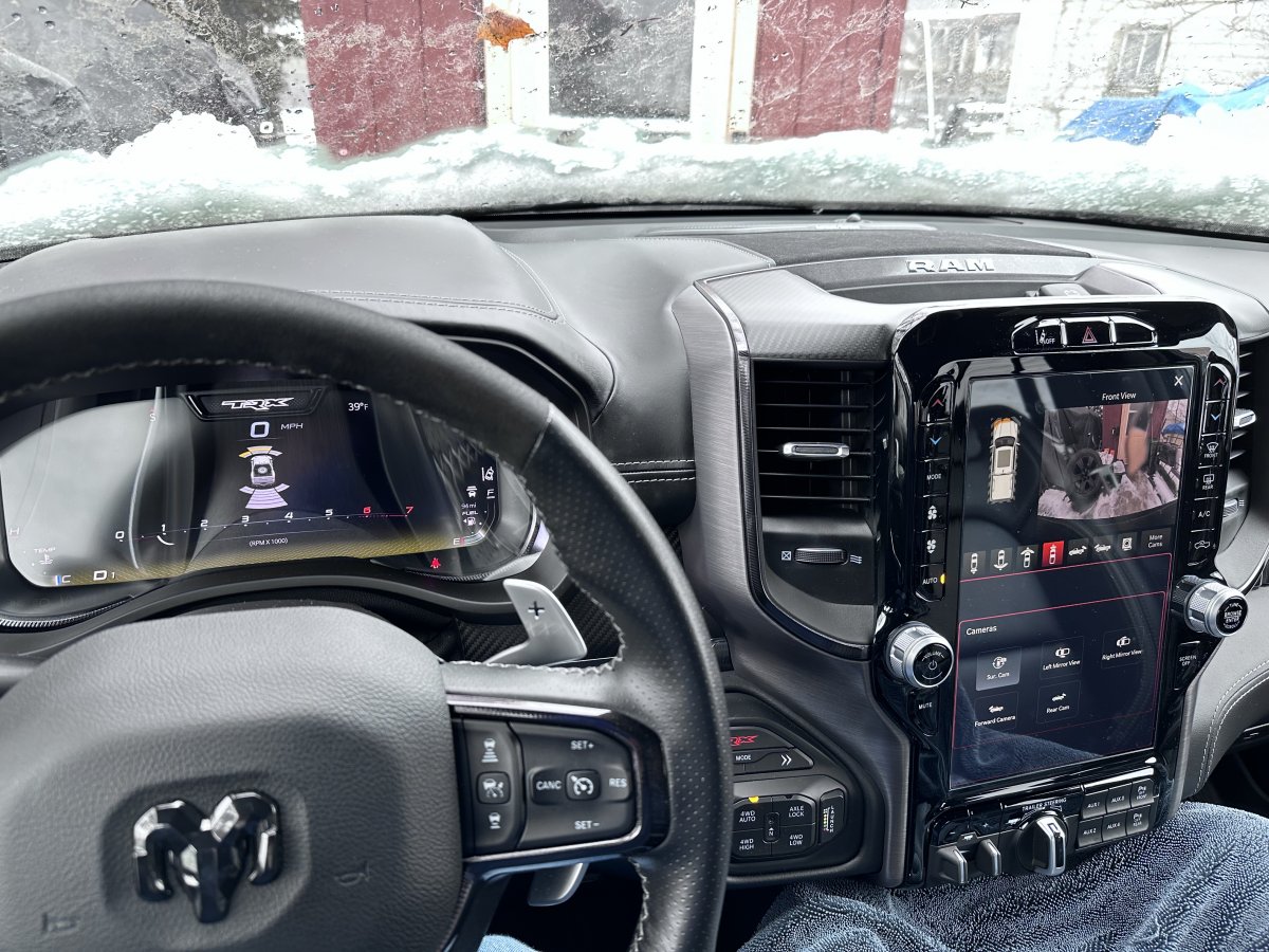

Also finally had warm enough temperatures to melt the snow off. Tested the park sense camera activation and it works great!
