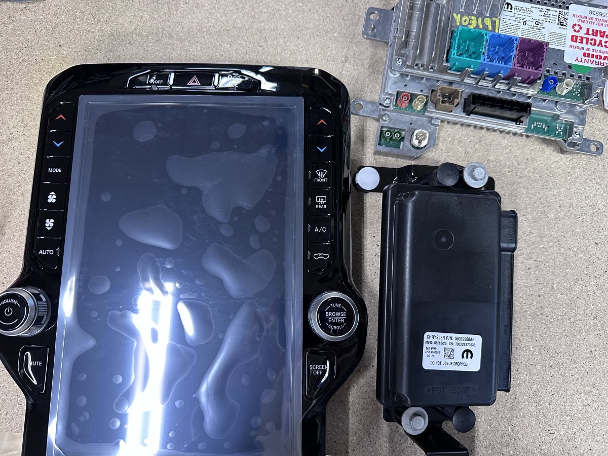

2023 CVPM landed so I just sat around looking at the stuff. Waiting on the adapter cables. Oh, and I have to buy an unlock code for the radio but that’s no big deal. I suppose I could install the CVPM ahead of time but I’d rather just do it all in one day since there’s nothing too difficult about the process.

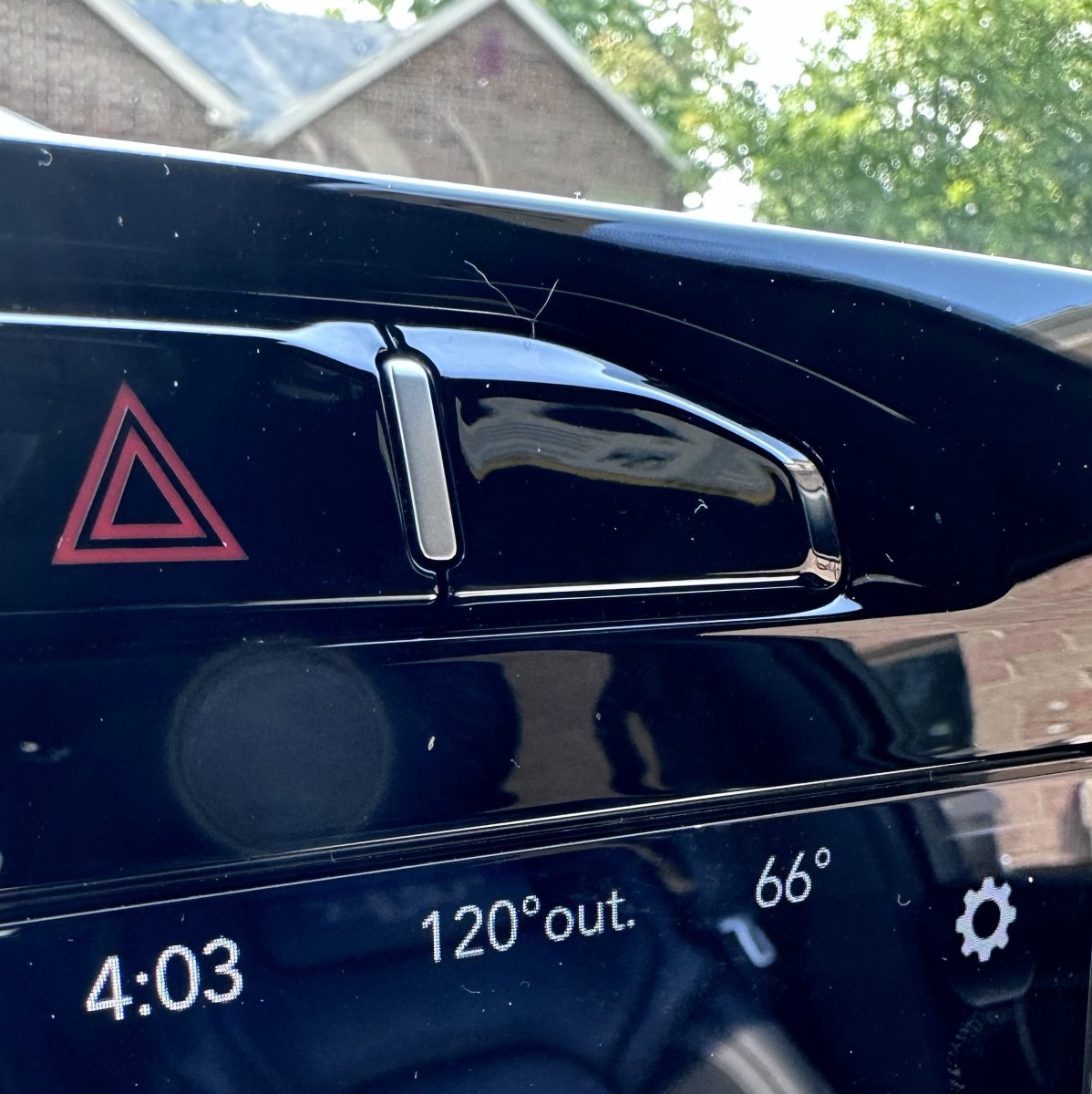

Still undecided on whether I’ll move my old blank switch into the position that has park assist. I took the screen apart pretty easily to access that switch bank so I can do either one. Do I want an annoying blank, or do I want a button that doesn’t work? My OCD says neither. Can’t win. Lol

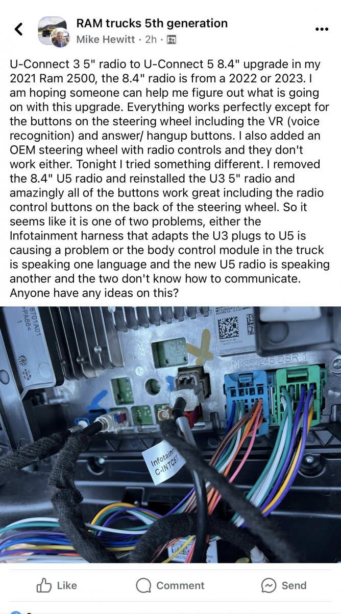

Think I’m onto something with the 2023 radio being needed for the tile button to work correctly. I saw this post just now on the 5th gen FB group.
I zoomed in and pulled the PN for his new radio, it’s a 2023-2024 unit (going into 2021 truck) and his original VR and phone buttons don’t work with it. Something has changed with how these switches interact with the radio module so with the proper radio I should be in business.

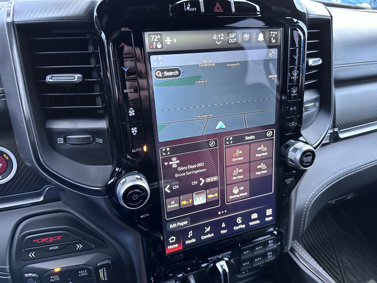

Still waiting for my cameras to show up but otherwise everything is working great. I LOVE UC5 so far. Really nice UI. I had no issue with UC4 but this is definitely better.

awesome. I see you decided to put the blank button in on the screen bezel
Yeah, I saved that switch panel and button for now…just in case I change my mind. But I think I like having the blank more than a dead button.
